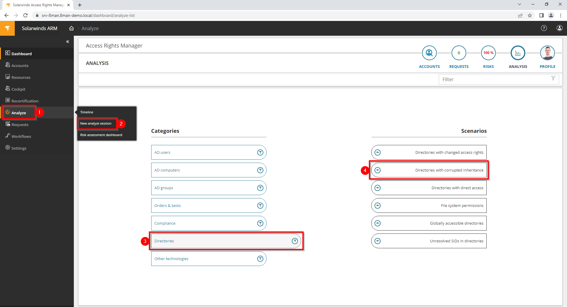

- Click Analyze.
- Click New analyze session.
- Select the category Directories.
- Click Directories with corrupted inheritance.

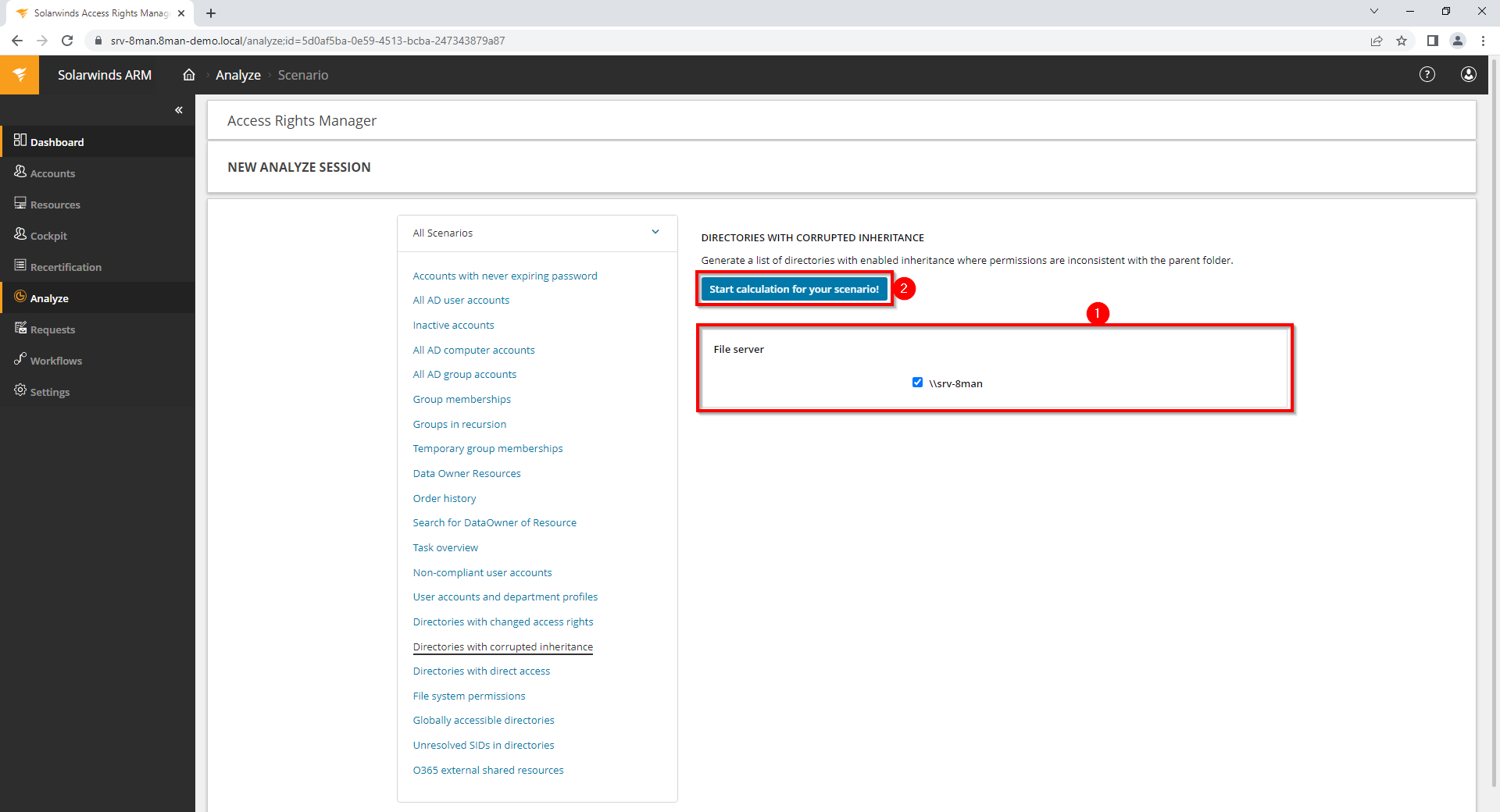

- Specify which file servers should be included in your analysis.
- Start the calculation.

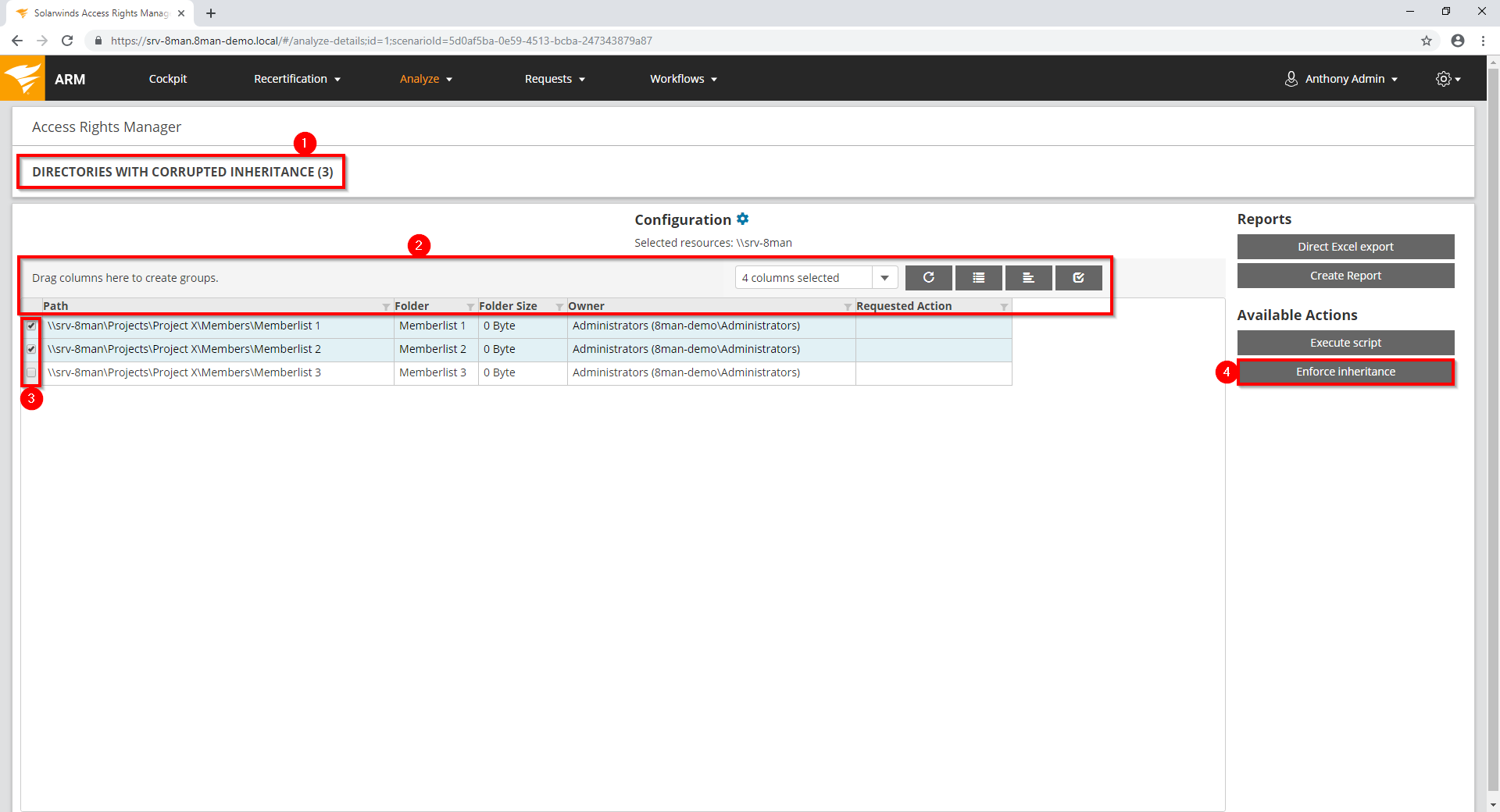

- Access Rights Manager lists all directories with corrupted inheritance.
- Use sorting, filtering, grouping and column selection to narrow down your selection.
- Select the desired entries.

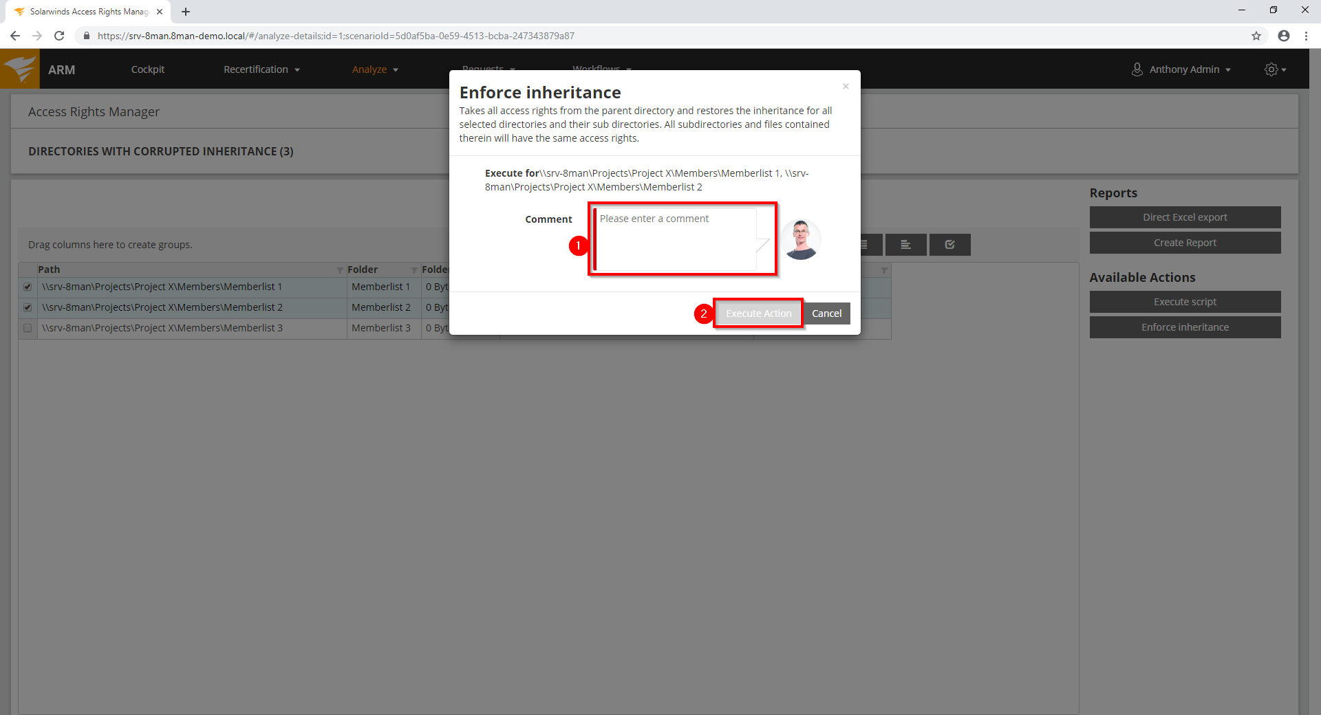

- Click Enforce inheritance.
- You must enter a comment.
                                    Click Immediately to execute the task or select another option.
The job will be transferred to the Access Rights Manager server and executed there. You can find the status in the Jobs overview.
