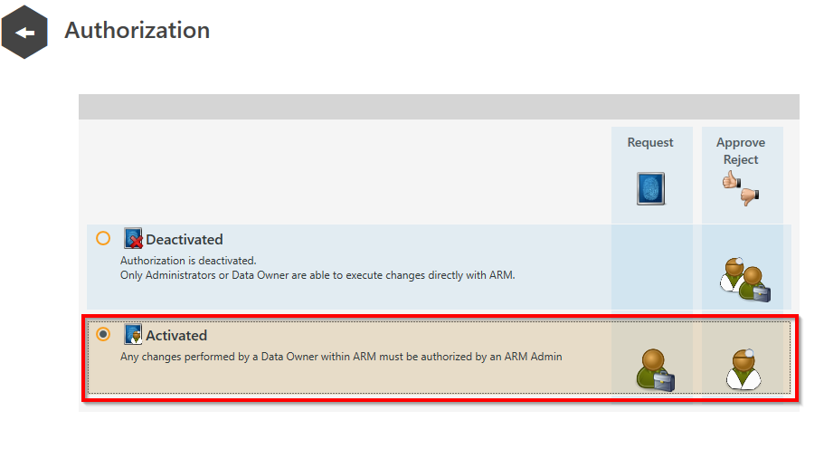

In the ARM configuration application select "Change Configuration">"Authorization".
Activate the administrator approval mode.

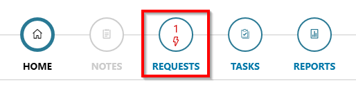

Administrators are able to see open requests on the home page. Click on "Requests".

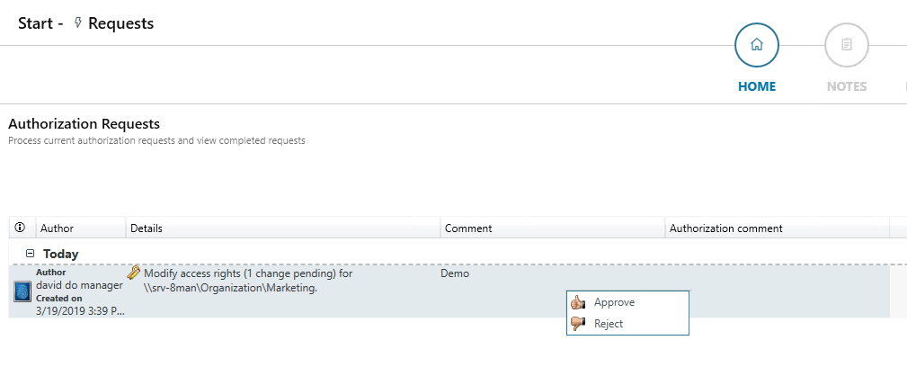

Right-click on a request and make your decision.

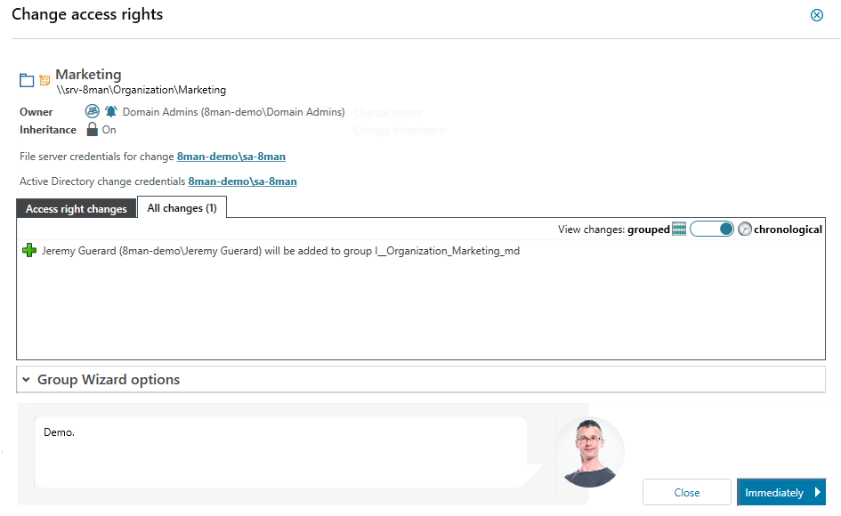

  1. ARM shows you details about the requested changes
  2. You must enter a comment.
  3. Click "Apply".
