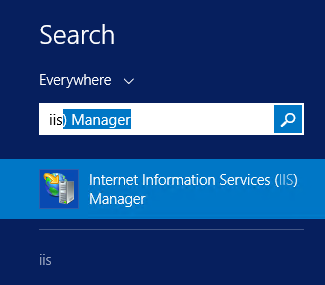

  1. On the CAS, start the IIS Manager.

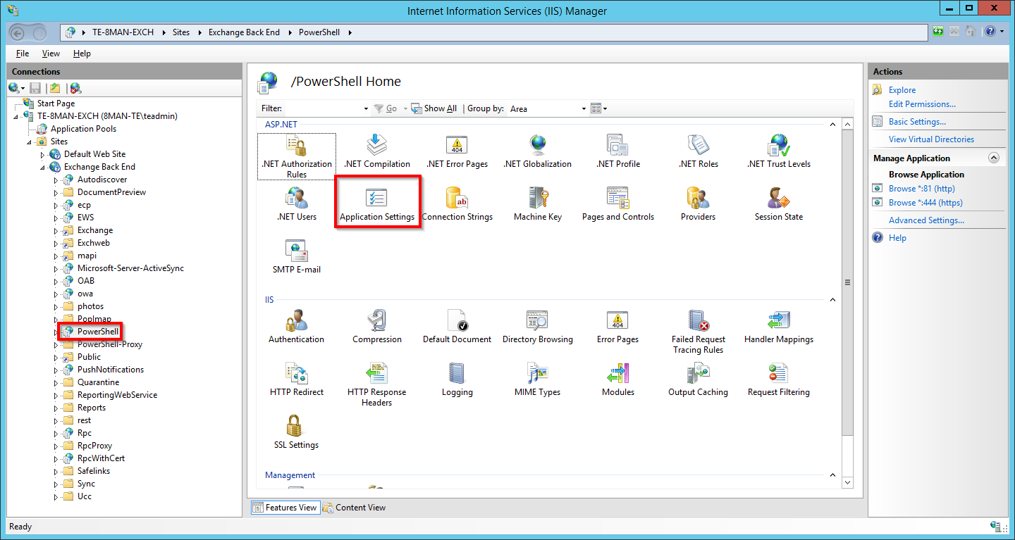

  2. Navigate to PowerShell.
    In Exchange 2016, 2019, and Subscription Edition (SE), PowerShell is located under Exchange Back End.
  3. Double-click Application Settings.

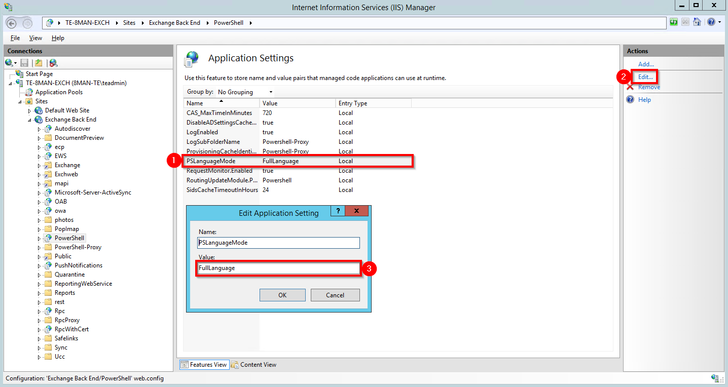

  4. In the Application Settings window, perform the following steps:
    1. Select PS LanguageMode.
      The PSLanguageMode FullLanguage is no longer needed.
    2. Click Edit.
    3. In the Value field, enter the following and then click OK:
      FullLanguage
      Cumulative Exchange updates may reset this setting.

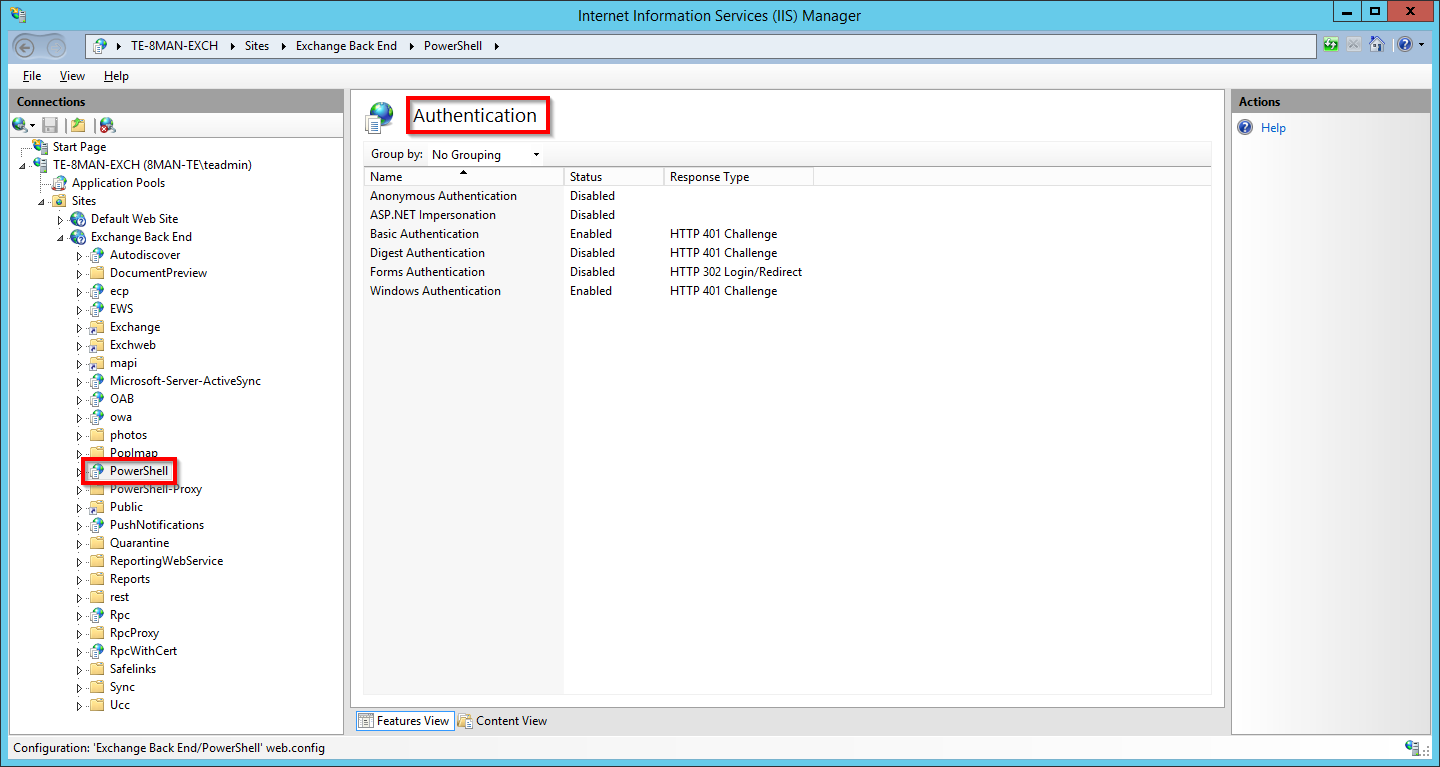

    4. Activate the desired authentication method.
Later, you must select the same authentication method in the Exchange configuration that you activate here.
Alternatively you can activate the authentication with PowerShell.
For example, Activate Windows-authentication (Kerberos).
Get-PowerShellVirtualDirectory | Set-PowerShellVirtualDirectory -WindowsAuthentication $true
You must restart the IIS to apply all changes.

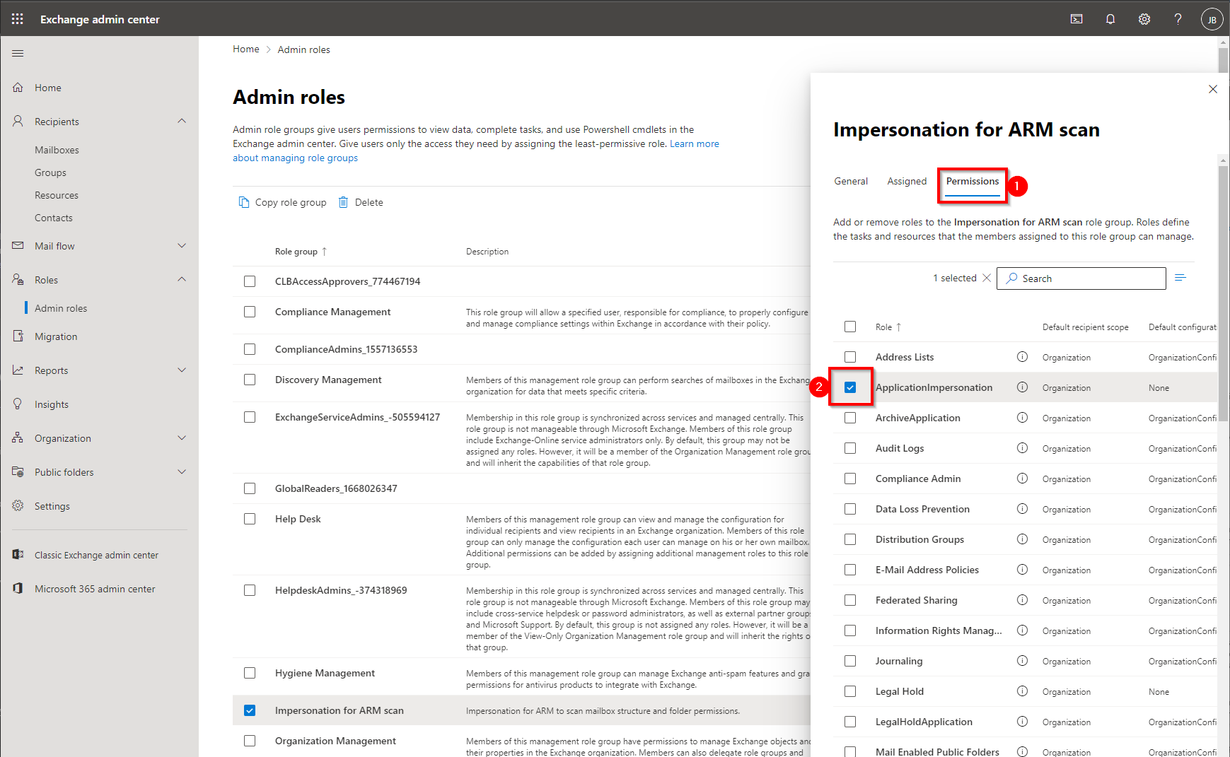

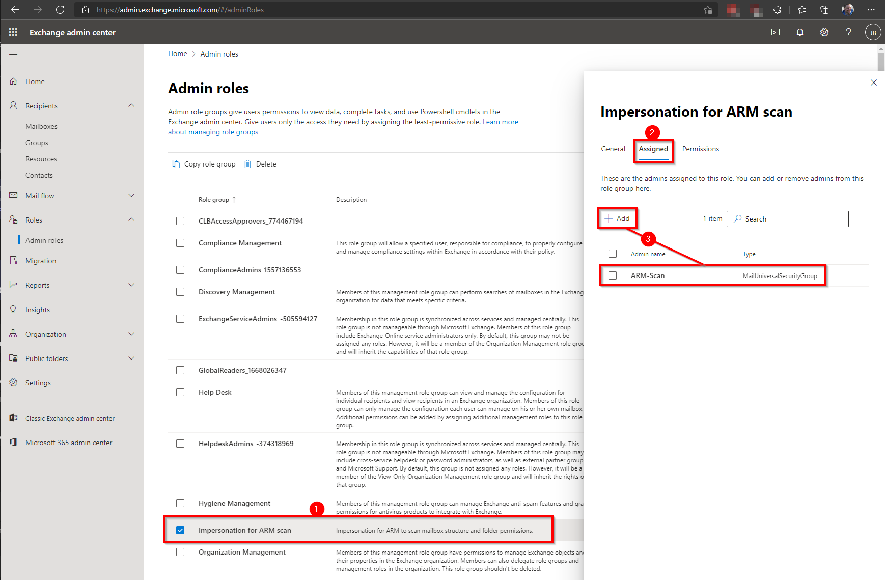

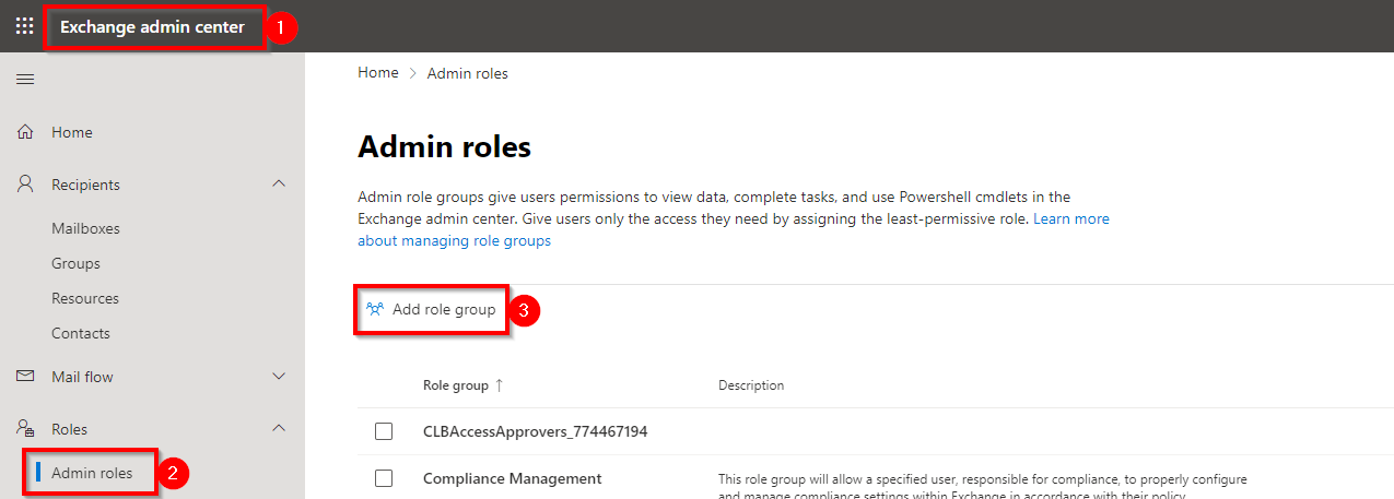

As an alternative to using the Microsoft process, you can use the Exchange Admin Center GUI.
  1. Log in to the Exchange admin center.
  2. Select Admin roles.
  3. Click Add role group.
  4. Update the Admin roles section.
    1. Select the new role and give an appropriate name and description.
    2. Click Assigned.
    3. Assign the account used for Exchange scanning to the role.
  5. Enable the permission.
    1. Click Permissions.
    2. Enable the following permission to the new role:
      ApplicationImpersonation
