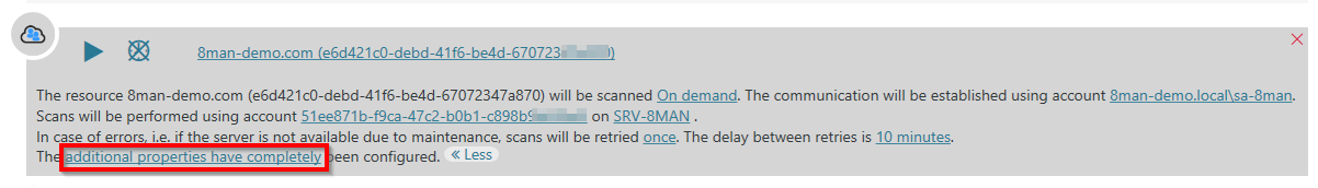

                                    Locate the Azure AD  scan configuration. scan configuration.
                                    In the configuration summary, click the additional properties link.

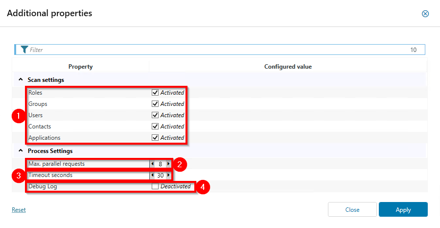

                                    In the Additional properties window, configure the scan and process settings.   -
                                            Under Scan Settings, select the scan scope.
                                            In the Max parallel requests setting, select the maximum number of parallel requests that will be sent to Azure AD. SolarWinds recommends eight requests.
                                            In the Timeout seconds settings, select how long ARM waits for a response from Azure AD before handling the request as failed. You can increase the value as needed if you receive error messages.
                                            In the Debug Log setting, select the checkbox to enable debug logging. Enable debug logging only for support in case of an error. Debug logging creates a large number of events being recorded and reduces the scanning speed.
                                    Click Apply.
