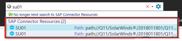

                                    In the Start Home page, enter a transaction code in the Search field and then press Enter. For example, su01. ARM displays the search results.

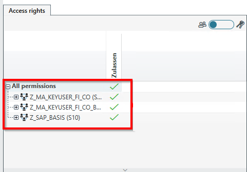

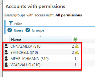

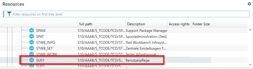

                                    In the search results, click the targeted resource. In the Resources column, ARM expands the permission structure tree view of the permission structure and focuses on the transaction code in your search.   In the Access rights tab, ARM displays all SAP users that have assigned the transaction code.   Under Accounts with permissions, ARM displays all permissions.   See Identify multiple authorizations for transaction codes for more information.
