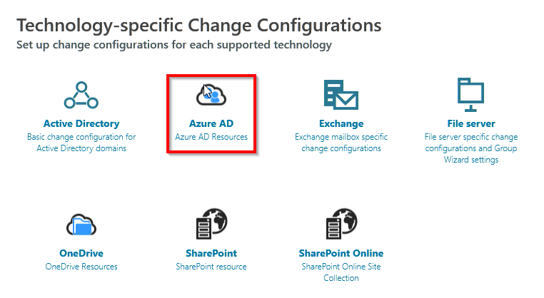

Azure Active Directory (AAD) change configuration
In the ARM configuration application, navigate to Change Configuration > Azure AD.

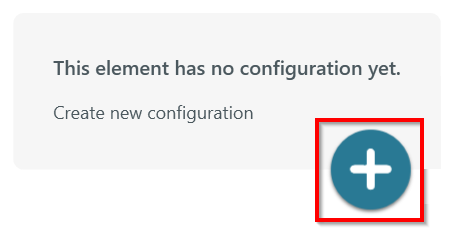

Add an AAD change configuration

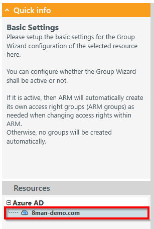

  1. Select an AAD resource.
  2. Click the plus icon.

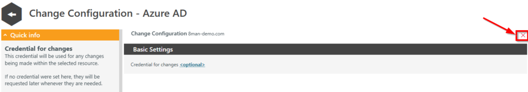

Specify which credentials are used to make changes to the AAD resource.
If you do not specify any, ARM users are prompted for each change.
Delete an AAD change configuration
Click on the red cross to delete an AAD Change configuration.
