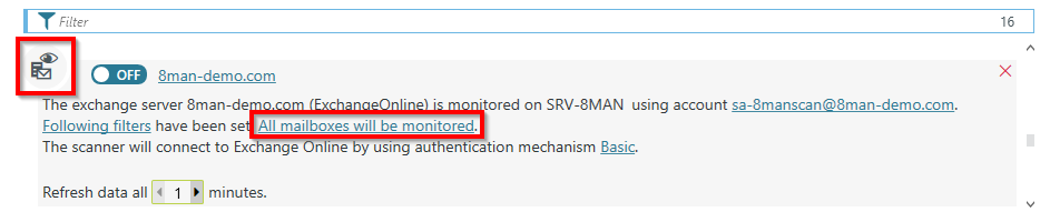

Select the mailboxes to monitor
                                    Click Scans.
                                    Click Logga - Exchange.
                                    Locate the Logga - Exchange  scan configuration. scan configuration.
                                    Click the All mailboxes will be monitored link. By default, all mailboxes are monitored.

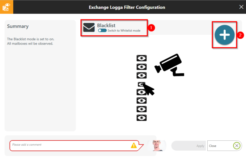

                                    In the Exchange Logga Filter Configuration window, configure the filter.   -
                                            Select a mode. Select Blacklist to monitor all mailboxes, including mailboxes you add at a future date. Specify which mailboxes are excluded from monitoring. Select Whitelist to select which mailboxes you want to monitor.
                                            Click + to add your entries.

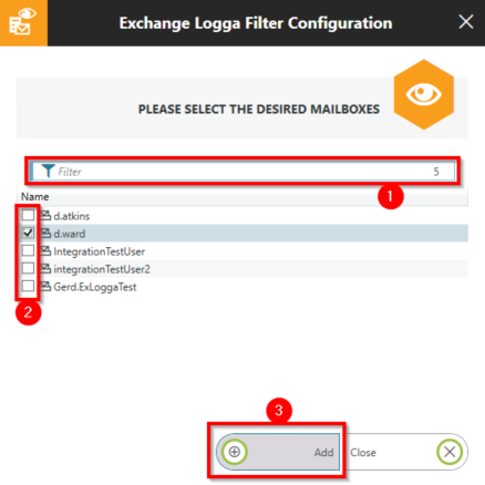

                                    Select the targeted mailboxes.   -
                                            In the Filter field, search for the targeted mailboxes.
                                            Click Add.

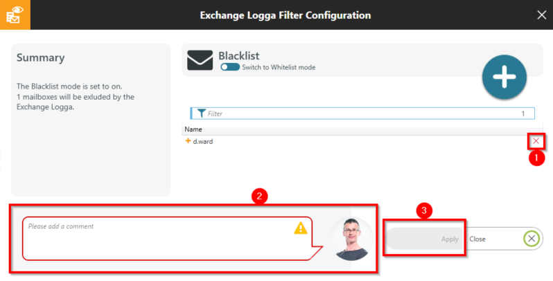

                                    Complete the configuration.   -
                                            Click X to remove any unwanted entries.
                                            Enter a comment that describes your changes.
                                            Click Apply to save the configuration.
