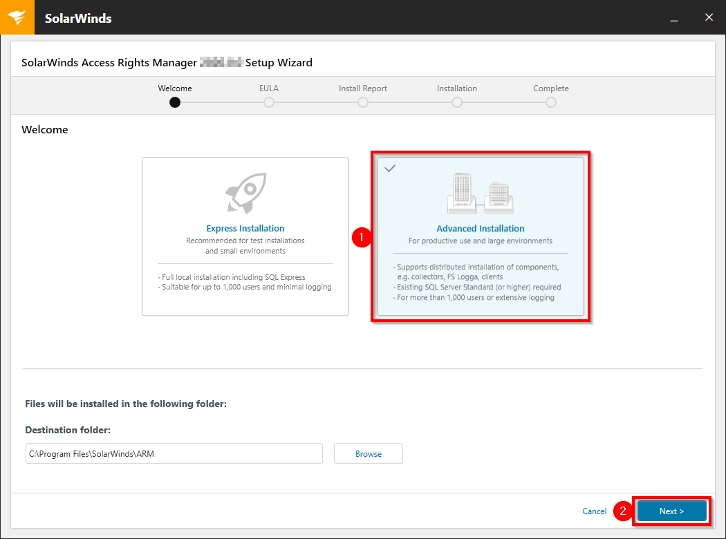

  2. In the Setup Wizard, select Advanced Installation, and then click Next.

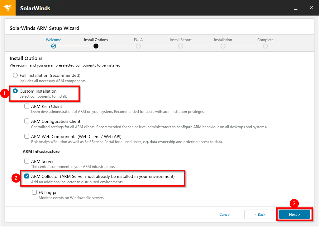

  3. In the Setup Wizard window, select Custom installation and ARM Collector, and then click Next.

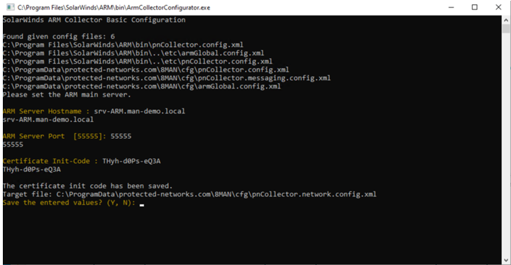

    During the collector installation procedure, the SolarWinds ARM Collector Basic Configuration window displays.
    To provide enhanced security, enter the ARM Server details (Hostname and port) and Initialization-Code (which can be generated from WebConsole > Settings > Connection Security).

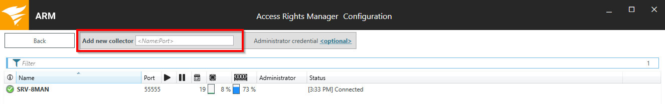

  3. In the Add new collector field, enter the fully qualified domain name (FQDN) of the targeted server, and the press Enter. If you do not use the default 55555 port, enter a port number after the name.

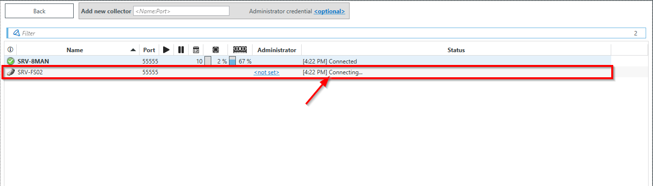

    If a collector is installed on the target system, the collector will be added to the collectors list and Access Rights Manager will establish a connection. Entering any login credentials is not required. You are finished.
    If you experience a connection issue, check your firewall. See Port requirements in the system requirements for troubleshooting.
    If the target system is located in a foreign (non-trusted) domain, see Run collectors in foreign domains (non-trusted) for instructions.
    If a collector is not installed on the target system, try to install the collector using the push method.

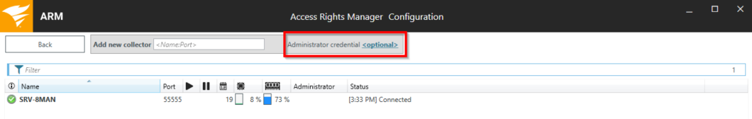

  4. Click the <optional> link next to Administrator credential.

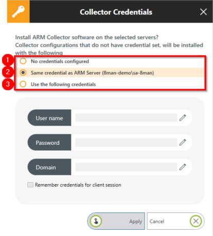

  5. In the Collector Credentials window, select an option:
    • No credentials configured: Removes the previously entered credentials.
    • Same credential as ARM Server: Installs the collector from the basic configuration.
    • Use the following credentials: Installs the collector using the credentials you enter in the User name, Password, and Domain fields.
  6. If prompted, enter the additional credentials used to install the collector.
  7. Click Apply.
    The installation status displays in the window.
