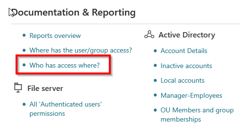

                                    Log in to the Access Rights Manager application.
                                    Click Start in the toolbar.
                                    Under Documentation and Reporting, click Who has access where.

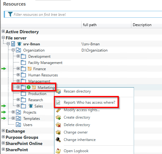

                                    Click the Resources tab.
                                    Right-click a directory that you are responsible for and select Report: Who has access where.

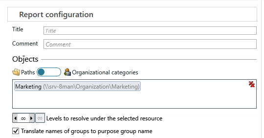

                                    In the Who has access where screen under Report configuration, enter a title and comment for this report. The selected resource automatically populates the list of objects to be analyzed. You can add additional resources, if needed.

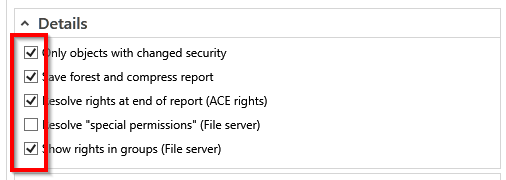

                                    Click the Details drop-down menu and set the report options. SolarWinds recommends selecting the options shown below for a first-run report.

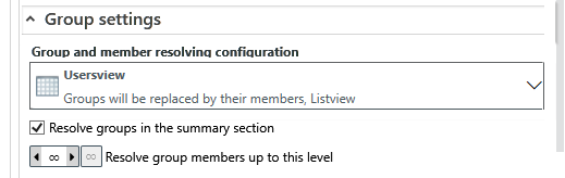

                                    (Recommended) Click the Group settings drop-down menu and select Usersview to reduce the report complexity.

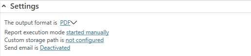

                                    Click the Settings drop-down menu and set the output options. For example, you can schedule and set the report to be sent to you by email on a scheduled basis.

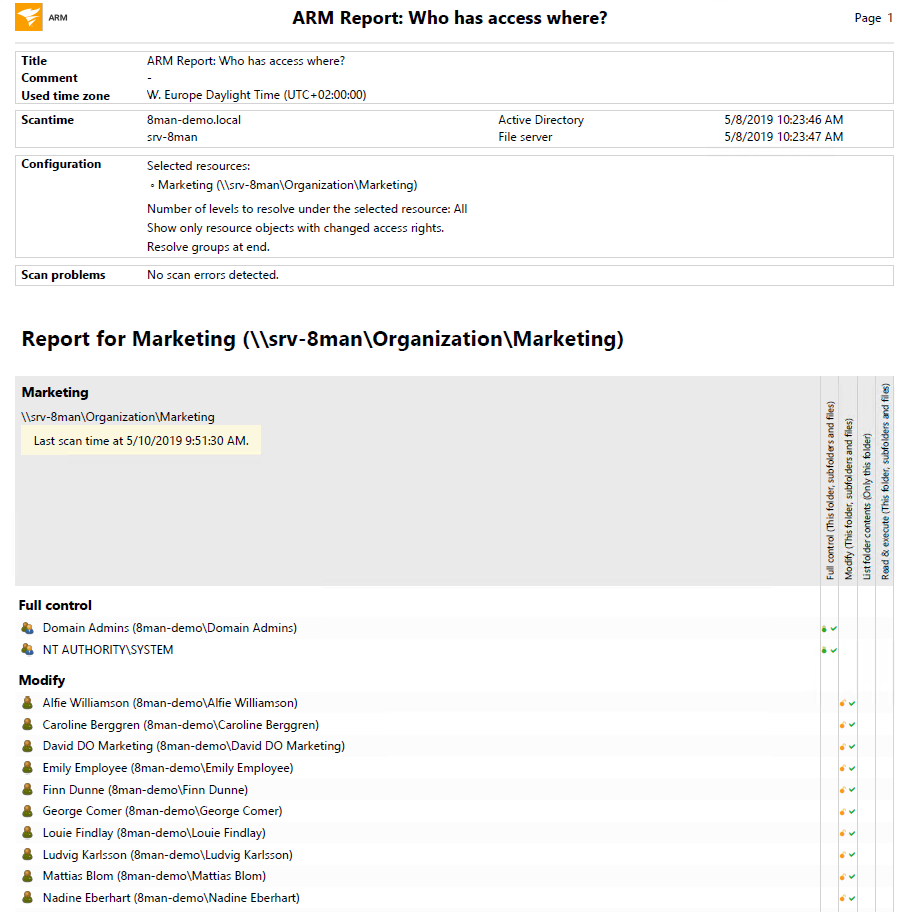

Report example
Below is an example of a Who has access where report. This report allows data owners to verify whether the listed users should have access to specific network resources.
Ensure that the access rights of some users cannot be reduced—for example, from Full access to Read or Modify. This ensures a higher level of data integrity in the report.
