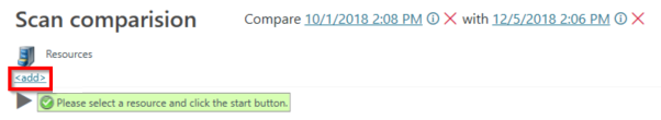

  1. Click Scan comparison.
  2. Select the two scans that you want to compare.

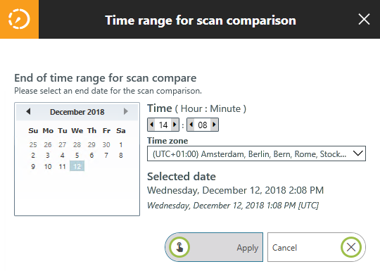

Specify the date and time for the start and end points.
The comparison always compares existing scans.

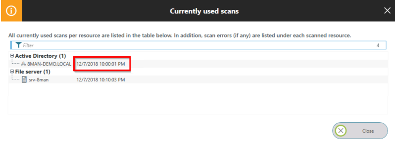

  1. Click on the information symbol.
  2. Date and time of the selected scan is indicated on the right-hand side.

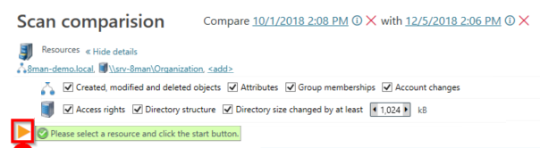

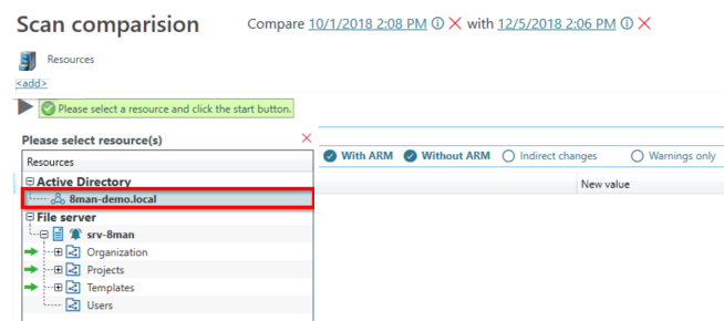

  1. Click Add.
  2. Add the desired resource by double clicking on it.

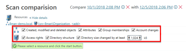

  1. Select the range of the comparison.
  2. Start the comparison.

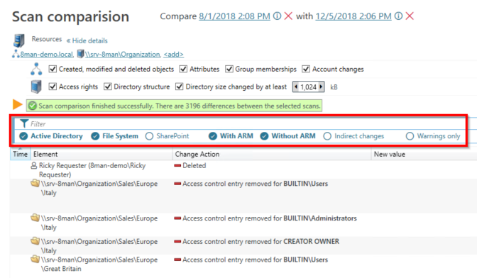

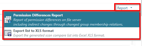

  1. Use filters to focus on specific actions.
  2. Generate a structured Permission Differences Report or export the results to .XLS.
