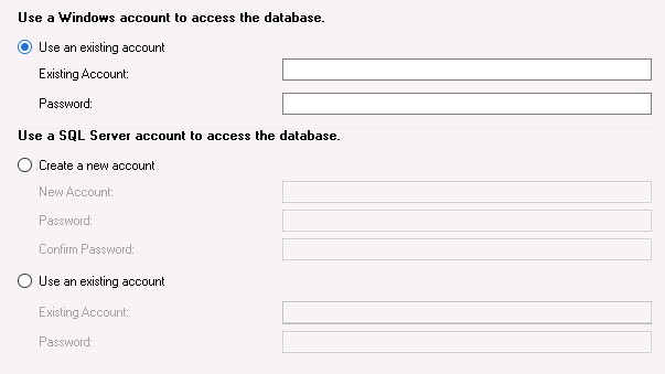

On the Database Account page, create an account or specify an existing account that the polling engine and SolarWinds Platform Web Console will use to access the database. The account can be a Windows (Active Directory or gMSA) or SQL Server account. See Database authentication types.

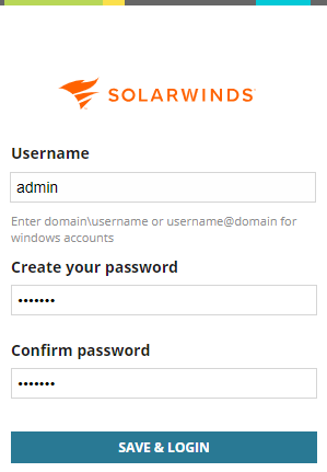

Log in with the user name
admin. Enter a password for the admin account, confirm the password, and then click Save & Login.
