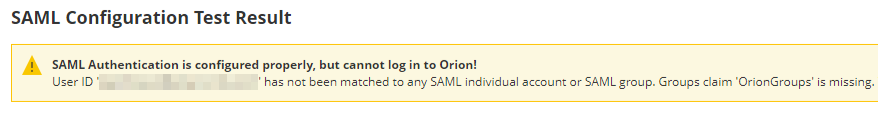

SAML authentication is configured properly but cannot log in to Orion
If you test the SAML configuration and the result says that the groups claim OrionGroups is missing, check your identity provider settings. Verify that the OrionGroups attribute is configured correctly. The attribute contains the user groups and is necessary for SAML groups authentication.
- For AD FS, see Step 2 (5) in Configure Active Directory Federation Services for single sign-on login to the SolarWinds Platform Web Console
- For Okta, see Step 2 (2e) in Configure Okta for single sign-on login to the SolarWinds Platform Web Console
