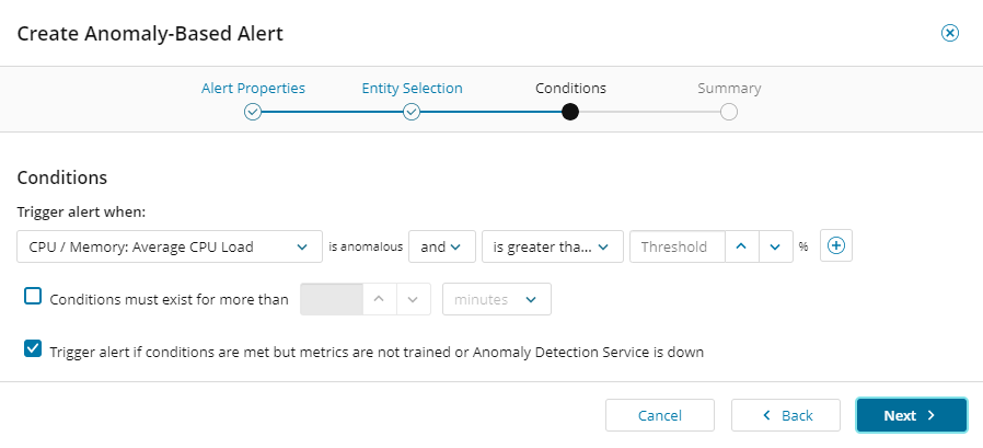

The wizard guides you through the process. Select the Entity Type and Entities you want to alert on and the conditions that should trigger the alert.
When you create an alert with multiple conditions, use an AND operator if all conditions must be met. Use an OR operator to trigger the alert if any condition is met.

By default, an Anomaly-Based Alert is not triggered until the training period has completed. If you would like the alert to be triggered based on the conditions you have configured, even if the training period has not completed, or if the Anomaly Detection Service is down or otherwise not available, you can check the “Trigger alert if conditions are met but metrics are not trained or Anomaly Detection Service is down” checkbox when you create the alert.
When this option is selected and an Anomaly-Based Alerts is triggered during the training or while the service is not available, the alert functions as a normal SolarWinds Platform alert that does not take advantage of anomaly detection functionality. After the training is complete, Anomaly-Based Alerts that were created with this option selected take full advantage of Anomaly Detection as long as the service is available.

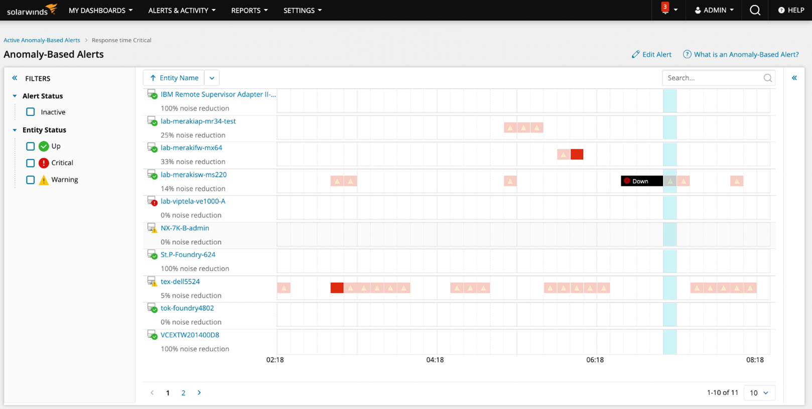

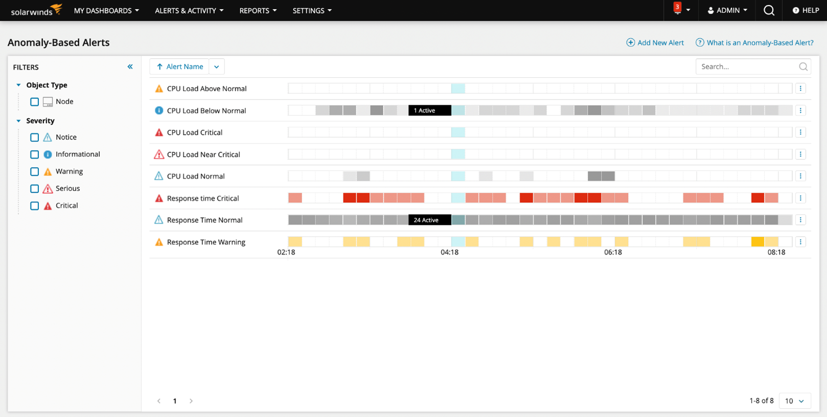

To see triggered Anomaly-Based Alerts, click Alerts & Activity > Anomaly-Based Alerts. Filter alerts by alert status or node status, and see all relevant Anomaly-Based Alerts that have been triggered.

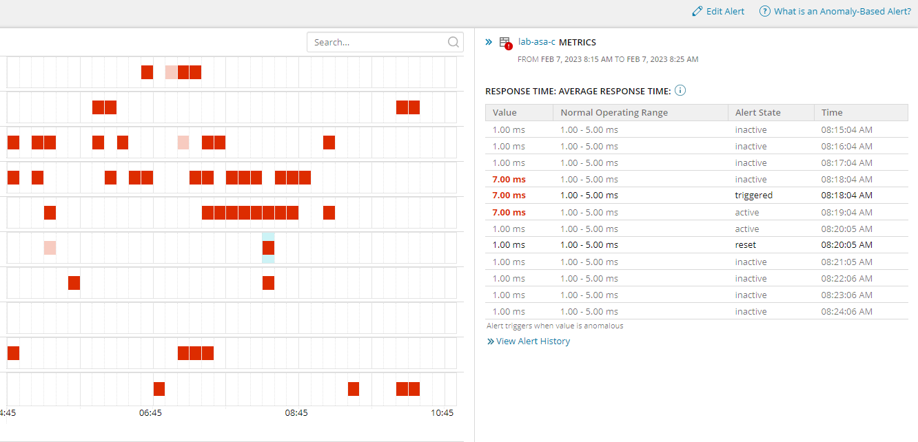

Anomaly-Based Alerts detail view
Click an anomalous alert on the timeline to see additional information on the right side of the screen, such as normal operating ranges (NOR) for the time intervals and associated metric value. This information gives you greater context for why an alert is considered anomalous.
