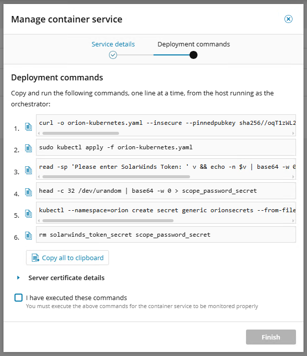

  1. Go to Settings → All Settings → Manage Container Services.
  2. Click Add, then select Kubernetes (v1.23-latest) as the environment type.
  3. Select or enter credentials and click Create Service to advance to the Deployment commands tab.
  4. In the Deployment commands tab:
    1. The first command contains the SolarWinds Observability Self-Hosted IPv4 address:
      ... https://192.168.0.1:38012/orion/ ...
      Update this to the SolarWinds Observability Self-Hosted IPv6 address, for example:
      ... https://[2001:0db8:85a3:0000:0000:8a2e:0370:7334]:38012/orion/ ...
    2. Run the first command on your Kubernetes server. This downloads the orion-kubernetes.yaml file.
    3. Open orion-kubernetes.yaml in a text editor and change the ORION_URL variable value from the IPv4 to the IPv6 SolarWinds Observability Self-Hosted address, for example:

                      - name: CONTAINER_AGENT_GUID
    4. Execute the rest of the commands as instructed.
  5. After all commands have been executed, select the checkbox to confirm, then click Finish.
