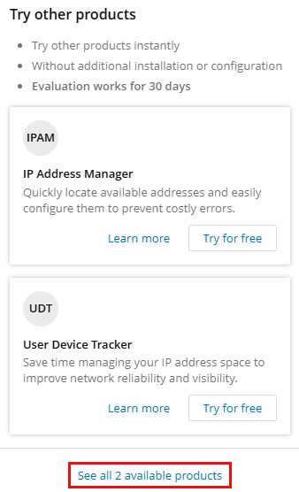

The License Manager page lists your licensed products and any evaluations (both active and expired). The right pane lists other SolarWinds Platform products that you can choose to install for evaluation.
The evaluation version of a product is a full version of the product, functional for 30 days. After the evaluation period, you can convert your evaluation license to a production license by obtaining and applying a license key. Contact SolarWinds sales to purchase a full license. To activate the license, see Activate licenses.
To view the entire list of products, scroll to the bottom of the right pane and click See all n available products.
Select the check box next to each product you want to evaluate.
Above the list, click Try for free.
A dialog prompts you for registration information.
Enter your email and other registration information, and click Try for free.
The evaluation products are activated. They are added to the list of products on the License Manager page.
