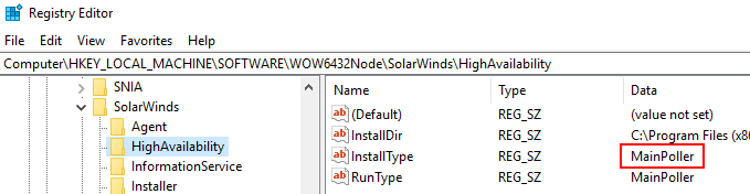

If HA is configured, be sure to run the installer on your primary SolarWinds Platform server, not a backup server. To verify, open the Windows Registry Editor and expand
Hkey_Local_Machine > Software > Wow6432Node > SolarWinds. Then click onHighAvailabilityand verify that theInstallTypeisMainPoller.
