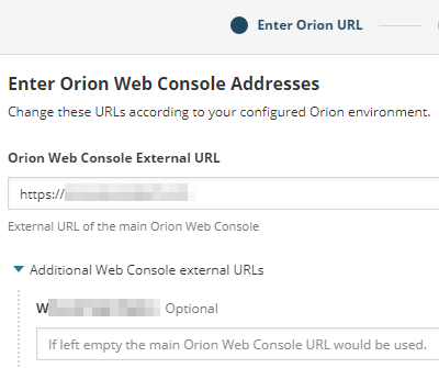

In the Enter Orion URL step, check that the external URLs are correct and adjust them if necessary.
SolarWinds Platform Web Console External URL
This is the URL of your SolarWinds Platform server or its DNS alias.
Additional Web Console external URLs
If you have Additional web servers deployed, check the URL(s) for the servers hosting the additional web console. The field should contain one of the following:
The address of the server hosting your Additional Web Console
Example:
https://solarwinds.my-company.com -
The DNS alias of the server hosting the Additional Web Console
Example:
https://orion -
No input
Clear the suggested URL. When you try to log in to the Additional Web Console using SAML authentication, you'll be redirected to the primary SolarWinds Platform Web Console

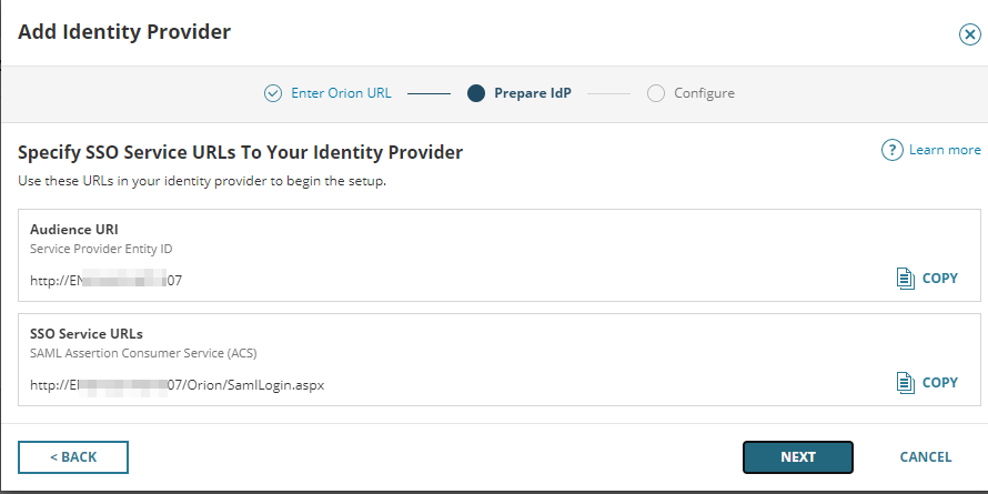

These URLs are used to generate the URL and URI you copy into your identity provider settings.
The Prepare IdP step provides Audience URI and SSO Service URL(s). You will copy and paste these values into Microsoft Entra ID in the next step.
Keep the browser open and continue in Microsoft Entra ID.
If you have deployed additional web servers, the SSO Service URLs section includes more URLs - one for the primary SolarWinds Platform Web Console and one for each additional web server.
