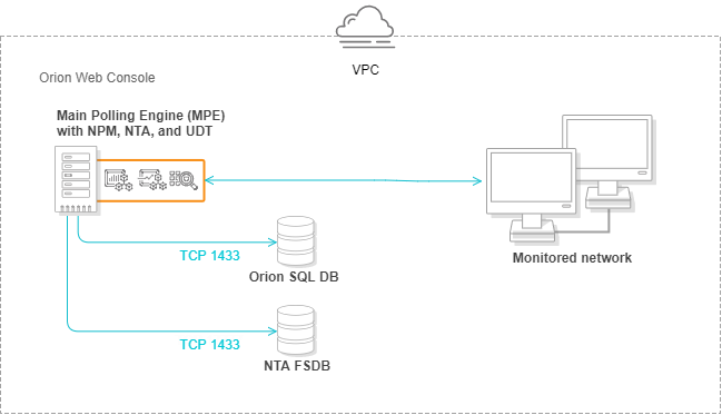

Cloud (main SolarWinds Platform server and database in the cloud)
SolarWinds recommends this deployment when your monitored environment resides mostly in the cloud, and you have a good understanding of how much computer capacity you require to monitor your environment.

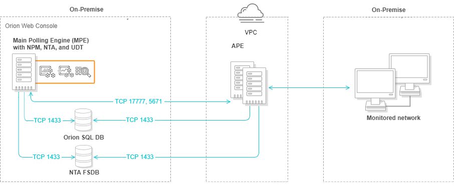

Hybrid (Additional Polling Engines in the cloud; main SolarWinds Platform server and database on premises)
Use this deployment type when the majority of your monitored network is on premises or if your hybrid environment is geographically diverse and uses different availability zones.
You can also deploy agents to your nodes in the cloud to reduce the amount of data transferred within the EC2 instance and from the EC2 instance to your main SolarWinds Platform server.
You will need to create a virtual private network tunnel between the Additional Polling Engine (APE) in the Amazon EC2 instance and your main Orion and SolarWinds Platform database servers.

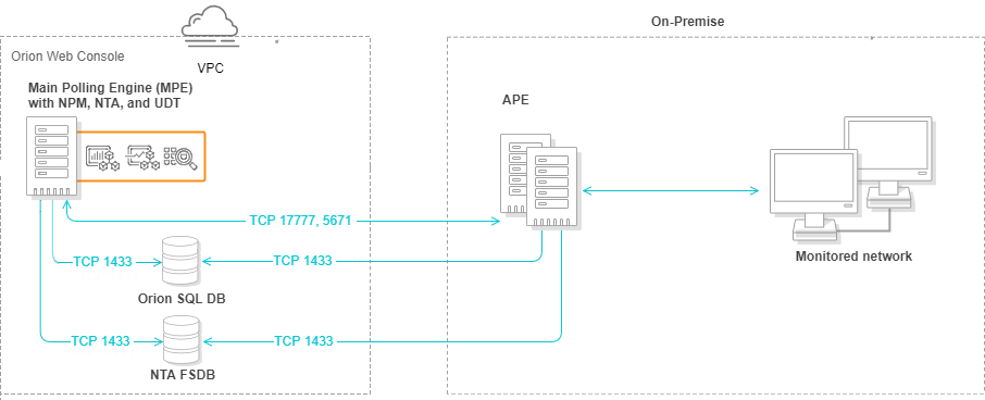

Hybrid (Main SolarWinds Platform server and database in the cloud; Additional Polling Engine on premises)
This deployment is recommended when your monitored environment includes a significant number of on-premises devices or if you are migrating your infrastructure to cloud.

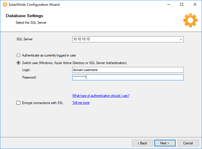

  3. If you performed a Standard installation with an existing SQL database, select one of the following for authentication:
    • Authenticate as currently logged in user: pass through authentication to the SQL server using the account currently logged in for installing the Orion product.
    • Switch user: provide separate SQL credentials.
    Unless you have joined your on-premises and cloud domains, you must use a dedicated SQL Server account. Windows authentication may not work as expected in the cloud.

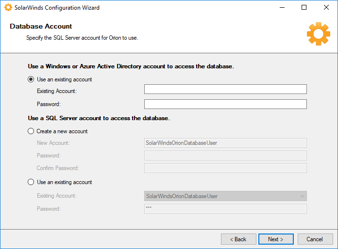

  5. In the Database Account dialog box, create an account or use an existing account that the polling engine and SolarWinds Platform Web Console use to access the database. The account must be a SQL account.
    We do not support creating a new SQL account through the Configuration wizard when the database is in the cloud.

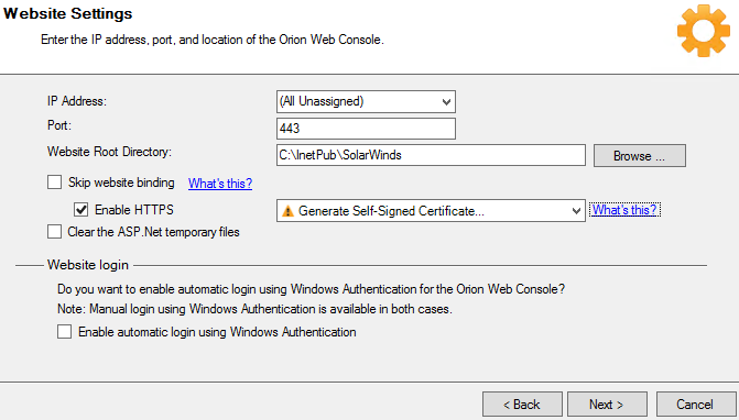

  6. In the Website Settings dialog box, complete selections for your installation:
    If you select Skip website binding, the Configuration wizard does not make changes within the website configuration in your IIS. This option blocks IP address, port, and SSL certificate options.
    1. Select All Unassigned unless your environment requires a specific IP address for the SolarWinds Platform Web Console. The Port is 80 by default.
    2. Specify the Port and the Website Root Directory where the system installs the Web Console files.
      If you specify any port other than 80, include that port in the URL used to access the Web Console.
    3. To configure SSL, click Enable HTTPS and select your SSL certificate.
      You must install your SSL certificate on the server before running the Configuration Wizard. You can install the certificate and run the Configuration Wizard again.
      If a certificate is not available, select the option to Generate Self-Signed Certificate. The Configuration Wizard automatically generates a self-signed certificate issued to the hostname or FQDN and adds it to the trusted certificate store.

    or
    Open a web browser on your SolarWinds Platform server and enter http://ipAddress or http://hostname, where ipAddress is the IP address of your server and hostname is the host name of your server.
    SolarWinds recommends using a public DNS name or IPv4 address.
  12. Log in with user name admin and leave the password field blank.
    For security purposes, SolarWinds recommends that you change the password to your admin account.
