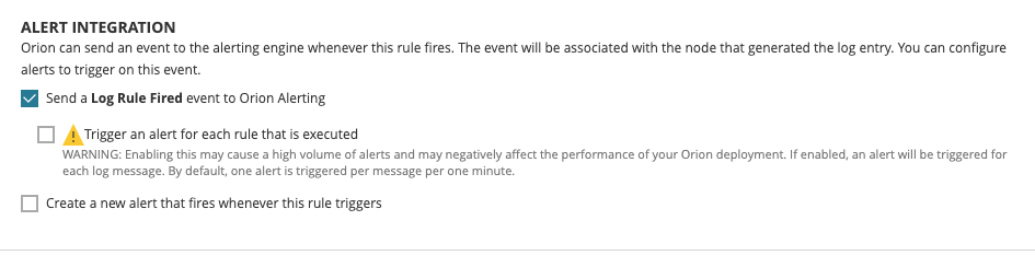

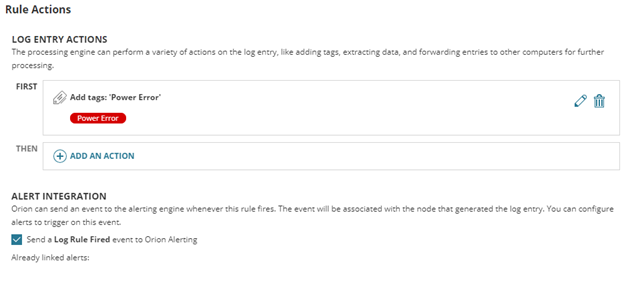

  4. To integrate an alert, click Next, and then click Next again to view the rule actions.
  5. To send a log rule fired event to SolarWinds Platform alerting, select the associated check box. This action allows you to see the event on the Manage Alerts page and use it when defining a custom alert.
  6. To create a new alert that fires when the rule is triggered, select the associated check box.

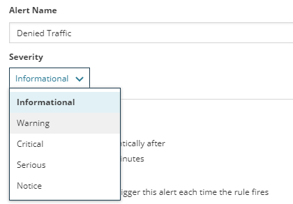

  7. Enter a name for the alert.
  8. From the drop-down list, select a severity level.

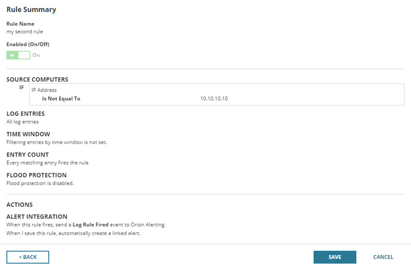

  10. Click Next. The rule summary displays the alert integration actions.
  11. Review the rule summary, and then click Save to apply the settings. To edit the rule conditions, click Back.

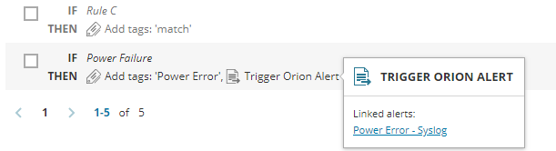

To view and access linked alerts, click Trigger Alert in your custom rules list on the Log Processing Configuration page.
