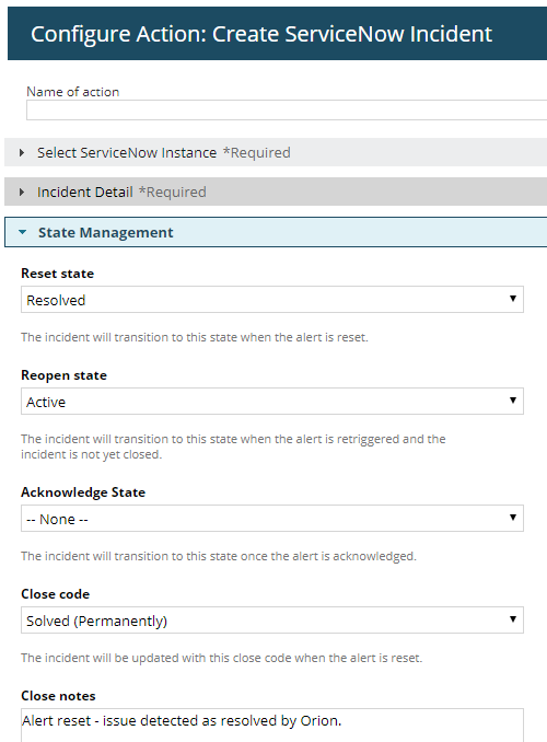

  5. Under State Management, define how the status of the incident in ServiceNow changes when the alert is reset, reopened, acknowledged, and closed.
    Options in the drop-downs provide states defined in your ServiceNow.
    You can also specify notes to be added to the incident.
