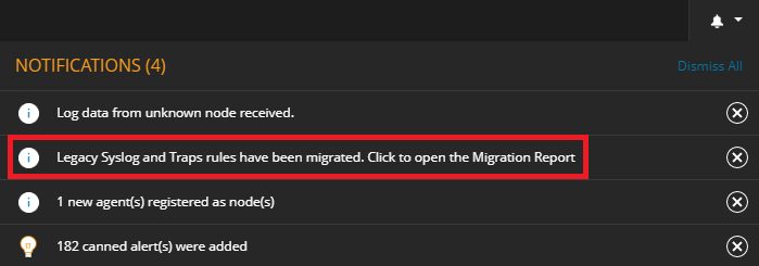

Once the rule migration is complete, a notification appears in the SolarWinds Platform Web Console with a link to the Rules migration report.

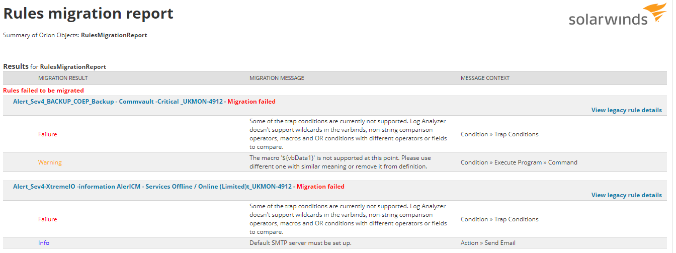

The report details the status of each migrated rule as follows:
  • Success - Rule migrated successfully
  • Warning - Rule migrated without the designated actions and is disabled
  • Failure - Rule was not migrated
  • Info - Rule successfully migrated but may perform differently than expected
You can also access the report in the SolarWinds Platform Web Console by navigating to Reports > All Reports > Rule migration report.
Click any rule in the Report to launch the Rule Builder for reviewing and editing the rule. Click View legacy rule details to view the original rule.
Migration results may vary based on the configuration of migrated rules. Rules are sorted based on the migration result and displayed by severity, from most to least critical.
Input legacy rule Status Migration result
The rule contains a condition that is not supported. Failure The rule is not migrated.
The rule contains an action which is not supported by migration. Failure The rule is created without that action and the rule is disabled.
The rule contains a misconfigured action supported by migration. Warning The action is not added to the final rule and the rule is disabled.
The rule contains needs additional setup or configuration and is supported by migration. Info The rule is migrated, but needs further configuration.
The rule contains actions and/or conditions supported by migration Success The rule is fully migrated.
