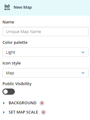

  1. In SolarWinds Platform Web Console, click My Dashboards > Home > Maps.
  2. Click New Wireless Heat Map.
  3. In the New Map panel, provide a Name and click Save. The panel header will display the name.
  4. Set a floor plan as the background (obligatory).
    1. In the panel, expand Background and click Browse.
    2. Select a background image as the floor plan. The item will be marked as done with a green icon.

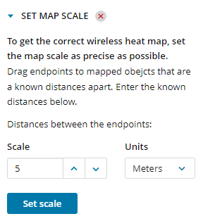

  5. Set the wireless heat map scale (obligatory).
    1. Expand Set map scale. A segment appears on the map.
    2. Find two objects on the map whose distance you know.
    3. Drag endpoints of the segment to these objects, fill in their distance and specify the unit (feet, meters).
    4. Click Set Scale to apply the scale.
    To set the scale more precisely, disable the Snap to Grid option. and Set the wireless heat map scale. Expand More in the top right and clear the Snap to Grid box.

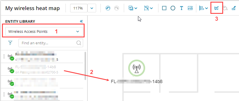

  6. Add wireless access points.
    The access points must already be monitored with your SolarWinds Platform product.
    1. In Entity Library, expand the drop-down list and select Wireless Access Points to display a list of monitored access points (1).
      You can also right-click a node in Entity Library and click Show related entities. This will display related entities including wireless access points in the panel on the right.
    2. Drag the access point to their location on the map (2).
  7. Click Generate Map (3) to display wireless signal coverage.
