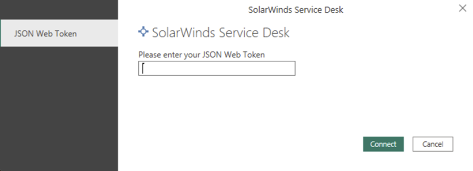

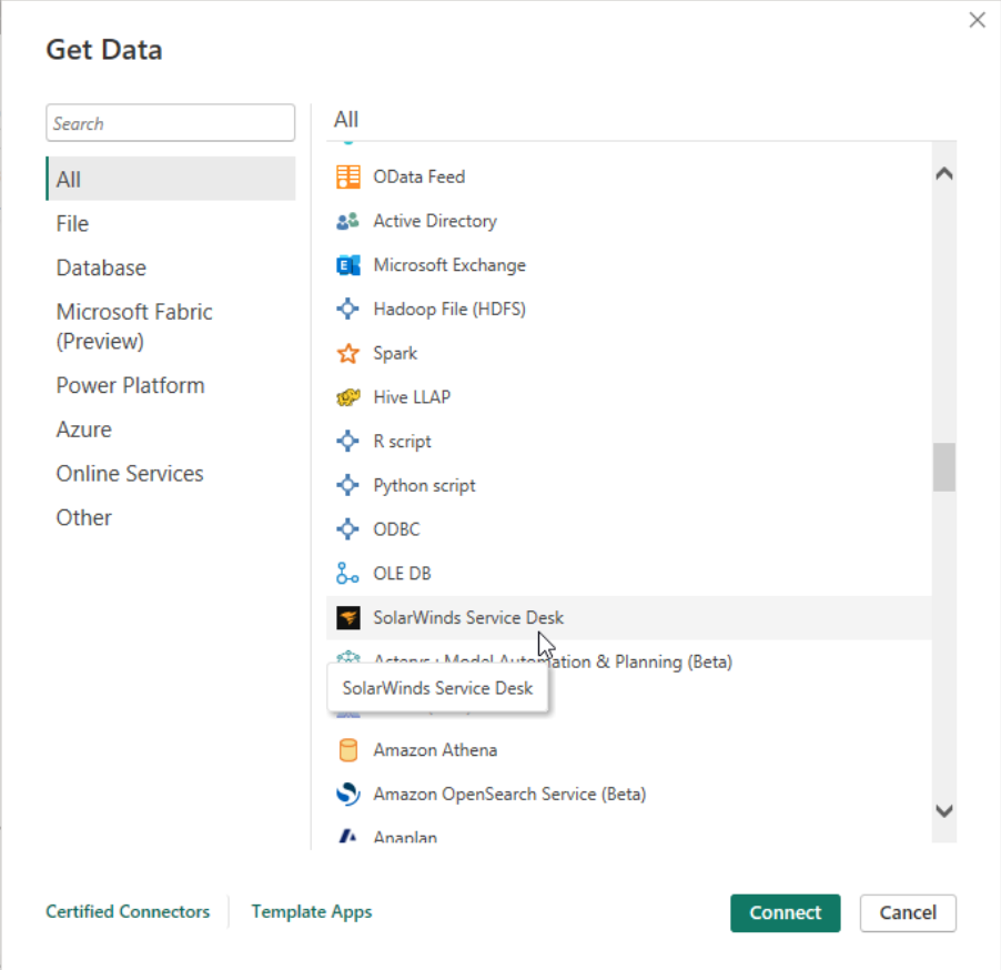

In Power BI Desktop, select Get Data from Home. Select SolarWinds Service Desk, and then select Connect.
Sign in with the JSON Web Token you generated as described in the Prerequisites, and then click Connect to verify your access to Service Desk.

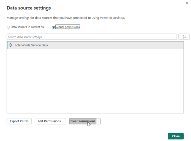

If you are not being prompted:
Cancel the current prompt to return to the main Power BI (Blank Template) page.
Click Transform Data > Data Source Settings.
In the Data Source Settings window, click the dropdown next to Clear Permissions and select Clear All Permissions.
After clearing the permissions, restart Power BI Desktop.

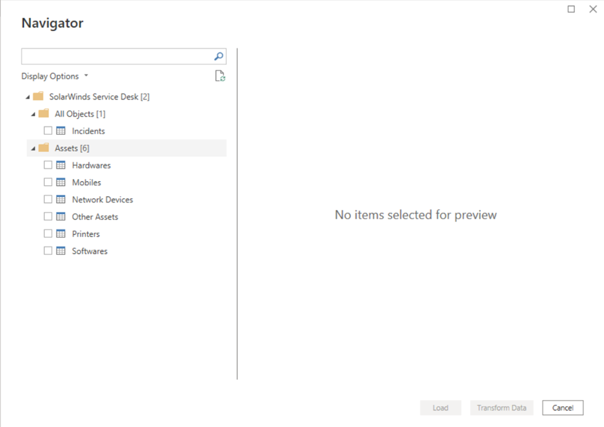

In the Navigator dialog box, select the table you want to import, and then click Load.
After completion of the steps above, you can see your chosen models load under Data view. The records you just imported were updated or created in Service Desk during last month.

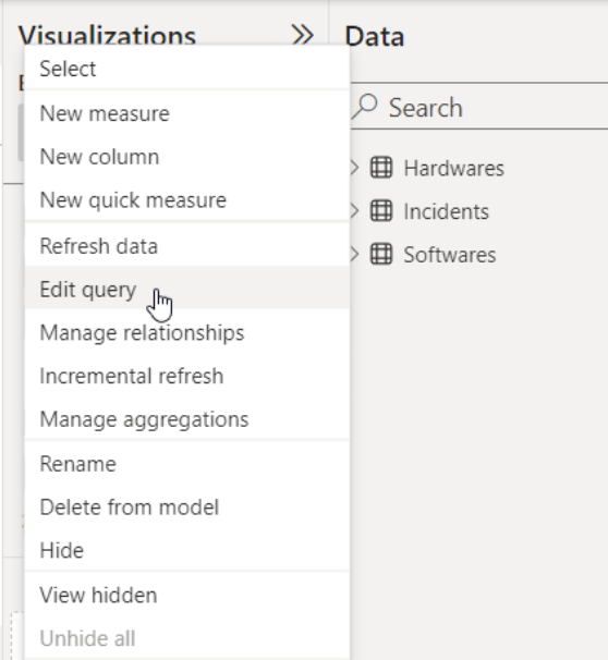

If you previously used the BETA Service Desk Power BI Connector to create reports, and you already have the model name Incidents and reports based on it, and you wish to connect those reports with the new out-of-the-box version:

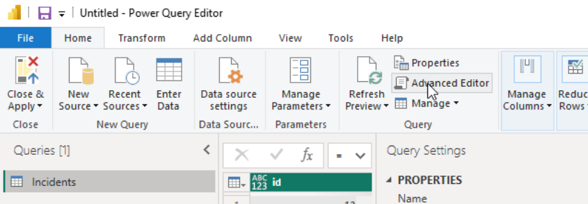

Go to the Incidents model, and right-click Edit query. A Power Query Editor opens.
Select the Incidents query and open Advanced Editor.

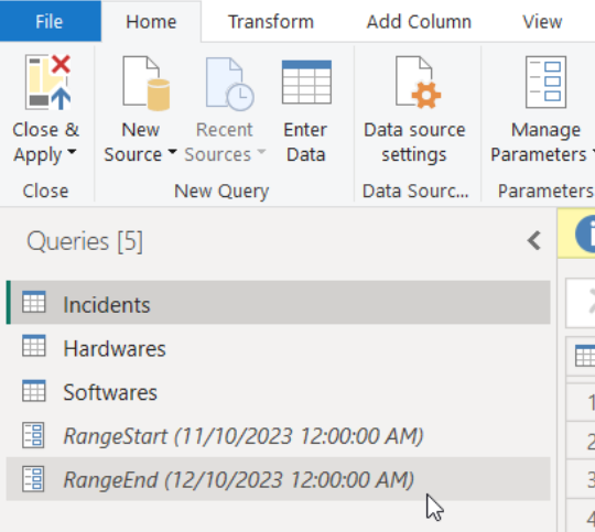

On the Home menu bar, click Transform Data. A Power Query Editor opens.
From the Power Query Editor toolbar, select Home > Manage Parameters > New Parameter.
Create two new DateTime parameters named
RangeEndandRangeStart.From the DateTime parameters, the connector ignores the Time, and uses only the Date.
The new parameters set the filtering range of the pulled data, based on the
updated_atcolumn. This reduces download time and filters your data based on the range you set.The
updated_atcolumn contains the last time the record was updated in Service Desk in the Server time zone. This is not the same as what is shown in the user interface; there it is based on the Account time zone setting. Because of this difference, when filtering the index, you might see a gap between the information there and what you see in a Power BI report.The filtering range provided by adding the parameters is
record.updated_at >= RangeStart(Date)andrecord.updated_at < RangeEnd(Date).Notice the difference between less than
RangeEndand larger than and equalsRangeStart.Set enough time between the parameters to allow you to pull sufficient records for your reports, but not too large. Select a range that won't cause you to wait a long time for every refresh. See Microsoft's instructions: create-parameters.Example
To pull records that were updated during a one-month period between
Nov 10, 2023andDec 10, 2023(not included), you would use:RangeStart = 11/10/2023 12:00 AMRangeEnd = 12/10/2023 12:00 AMThe filtering range provided by adding those parameters is
record.updated_at >= Nov 10, 2023andrecord.updated_at < Dec 10, 2023.In this example, records that were updated by Dec 10, 2023 will not be pulled.

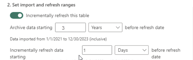

Incremental Refresh
Incremental Refresh saves download time after your initial download is performed.

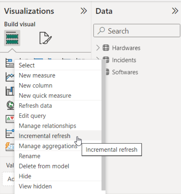

For each model you've downloaded, define the policy for Incremental refresh and real-time data as described below.
Set the option for archiving data to meet your reporting needs. Enter a number in the first field and use the dropdown to select a time frame.
Incrementally refresh data starting 1 Days before the refresh date. See define-policy for instructions.

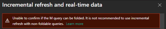

If you see an error message regarding confirmation of the M query, you can ignore it.

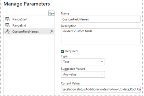

Create new parameter with the following:
Type: Select Text from the dropdown menu
Suggested Values: Any value
Current value: Specify the custom fields you want to add to model.
Enter the custom field names exactly as they appear in Service Desk (be sure to use the custom field name; not its ID).
To add multiple custom fields, separate them with commas.
Click OK in the lower right.
In Power Query Editor select the Incidents query, then navigate to Home > Advanced Editor.

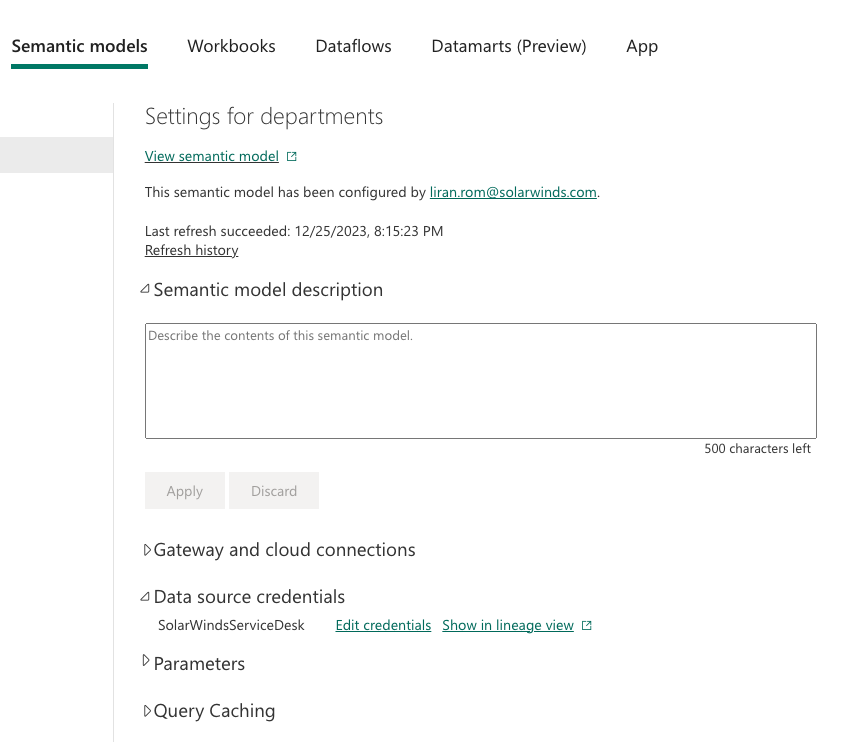

Establish settings for each published semantic model in the Power BI Service.

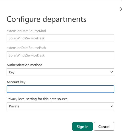

For each semantic model, open the Data Source Credentials section and edit the credentials with the key and token you used when you established the connection with the connector in Desktop Power BI.

Credential error in the Navigator
If a credential error occurs in the Navigator, clear your recent data source settings.
In Power BI Desktop, select File > Data source settings.
Select the Service Desk data source, and then select Clear permissions.
Establish the connection to the Navigator again.
