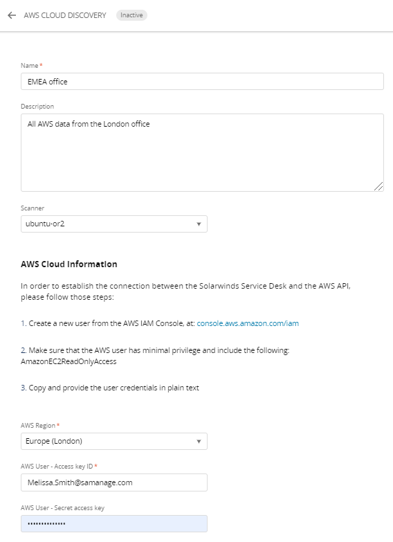

Navigate to Setup > Discovery & Assets.
From the All Connections index page, click the Add
icon, and from the dropdown menu, select AWS.
In the AWS Cloud Discovery dialog, follow the instructions provided.
Use the information below to help in configuration.
Fields with a red asterisk (*) are required.Field
Description
Name*
Create a meaningful name that will provide you with significant data.
Name is for your ease and convenience. This information does not affect the scanning process.
Description
Provide a meaningful description of the data.
Scanner
Select a scanner from the dropdown menu, which will establish the connection with the AWS API gateway.
AWS Region*
Mandatory field
AWS User - Access key ID*
Mandatory field
AWS User - Secret access key
Personal password
Click Create on the top right of the screen to save the connection.

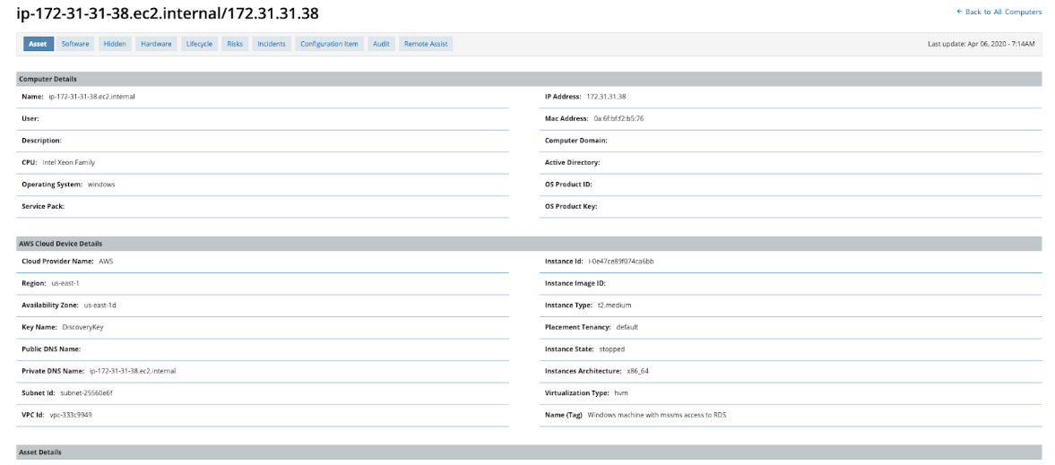

After the connection is established, the scanner imports EC2 data from the AWS Cloud into your Service Desk database as an asset, including details such as CPUs and memory. In addition, details from AWS Cloud are included such as region, zone, and other information.
Below is an example of the details extracted:
