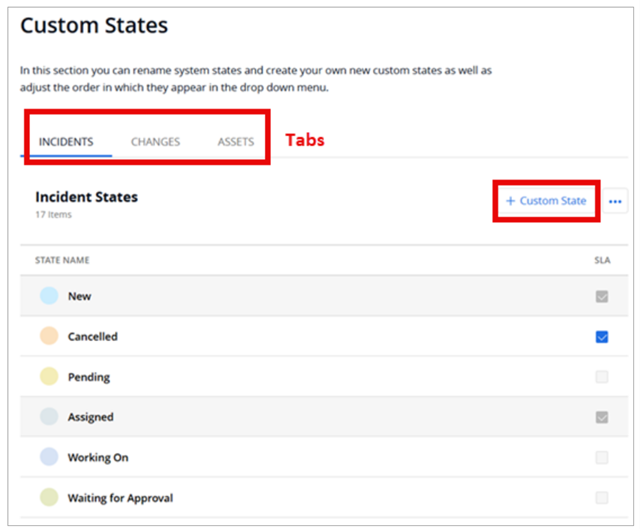

  1. In Service Desk, navigate to Setup > Global Settings > Custom States.
  2. To see the custom states related to incidents, click the Incidents tab.
  3. Create a Custom State for assets by clicking + Custom State.

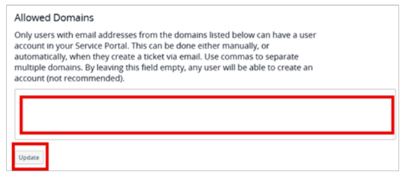

Set up allowed domains:
  1. In Service Desk, navigate to Setup > Global Settings > Service Portal.
  2. Scroll down to Allowed Domains.
  3. Remove all domains from the text field and click Update.

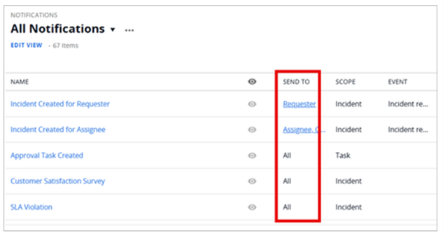

Disable Service Desk notifications:
  1. In Service Desk, navigate to Setup > Service Desk > Notifications.
  2. Disable all notifications from the Send to column to stop alerts during migration.

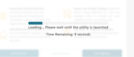

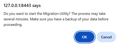

  1. Launch the migration utility.
    1. Go to the Web Help Desk server machine and login into the Web Help Desk application with an admin user account.
    2. Go to Setup -> General -> Migrate Your Data. Scroll down to the bottom and click Start Migration.
    3. From the confirmation alert popup, click OK.
      The utility tool launches after confirmation.

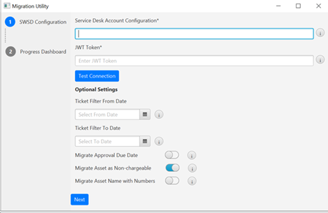

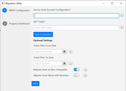

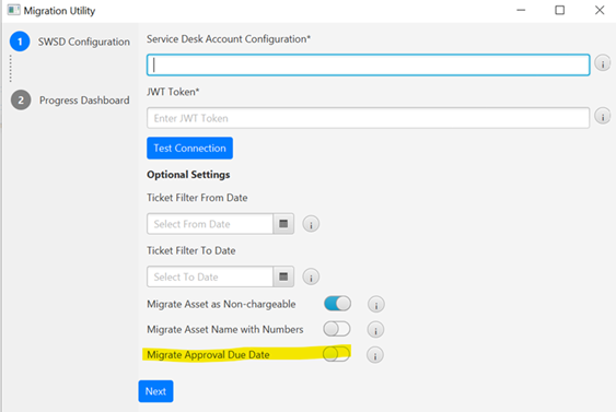

  2. Configure Service Desk account and JWT token.

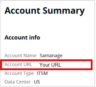

    1. In Service Desk, navigate to Setup > Account > Account Summary and copy the Account URL from that page.
    2. Go to the utility tool and add your account URL. Be sure to add https:// before the URL.

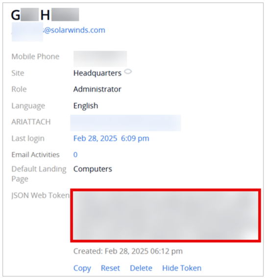

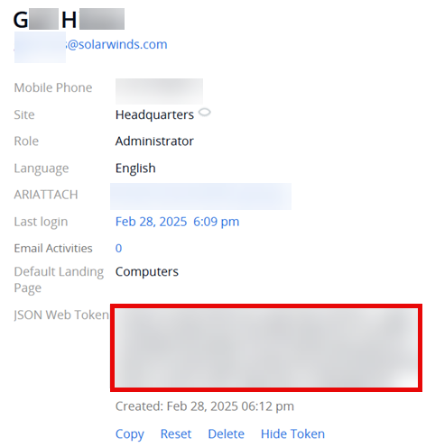

    3. In Service Desk, navigate to Setup > Users & Groups > Users.
    4. In the Name column, select the user account (with Administrator role) that was used to set up your Service Desk account.
    5. Click Actions, and from dropdown select Generate JSON Web Token.
      Directly under the Default Landing Page field, the JSON Web Token field expands to show the new token.
    6. Click Copy.
    7. In the utility tool, paste the Web Token and click Test Connection to validate the URL and token.

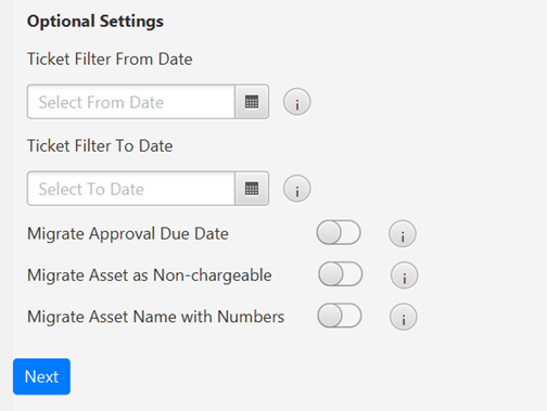

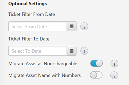

  3. Optional configuration.
    • Configuration settings to migrate data for specific time ranges:
      • Ticket filter fromDate - If you want to migrate data for the last 3-6 months or the last half year, set the fromDate in Ticket filter to fromDate field. Example: Default fromDate value: 01-Jan-2001
      • Ticket filter toDate - If you want to migrate data up to a specific date, set the toDate in Ticket filter to toDate field. Example: Default toDate value: CURRENT_TIMESTAMP
    • Migrate Assets as non-chargeable - The utility tool moves all assets based on their categorization and whether they are chargeable. If this setting is disabled, all assets are moved to the Other_Assets category and IP address information is stored in the Description details.
    • Migrate Asset name with numbers - The utility adds Asset: as a prefix to the asset name, resulting in the asset name Asset: + AssetNumber. If this setting is enabled, the asset name becomes only AssetNumber.

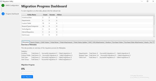

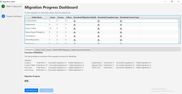

  4. Click Next to move to the next screen, Progress Dashboard.

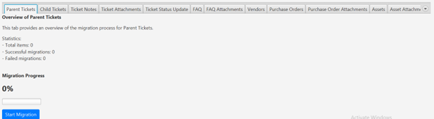

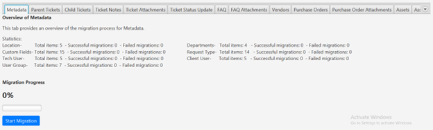

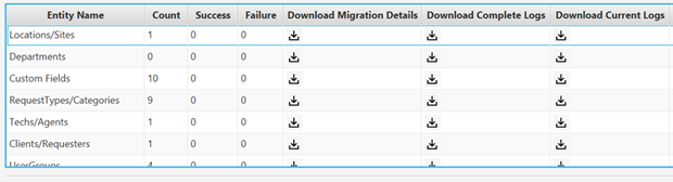

  5. Familiarize yourself with the data migration screens.

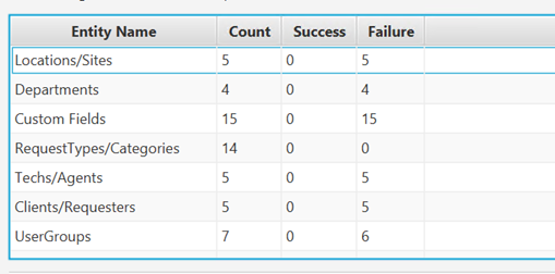

    The tabular data shows the total count of the data available in Web Help Desk and success / failure count of migrated data.
    • Download Migration Details: downloads respective entity success and failed json files of migrated data in the specified directory.
    • Download Complete Logs: downloads a zip file of the log folder in the specified directory.
    • Download Current Logs: downloads the latest log file in the specified directory.

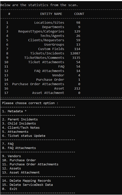

    The tabs for migrating Web Help Desk data.

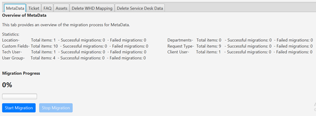

    • Metadata - Migrates all metadata (Locations/Sites, Departments, Categories, Custom Fields, Tech, Clients and User Groups) from Web Help Desk to Service Desk.
      *The Metadata option is mandatory.

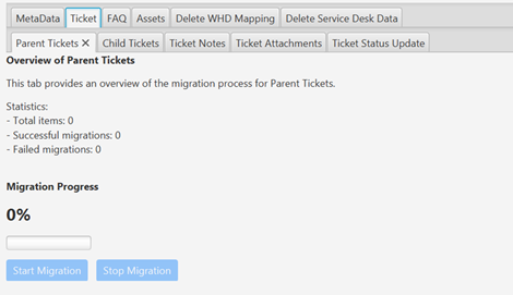

    • Ticket
      • Parent Tickets - Migrates all parent incidents data from Web Help Desk to Service Desk.
      • Child Tickets - Migrates all child incidents data from Web Help Desk to Service Desk.
      • Ticket Notes - Migrates all client/tech notes data from Web Help Desk to Service Desk.
      • Ticket Attachments - Migrates all Ticket and Notes attachments data from Web Help Desk to Service Desk.
      • Ticket Status Update - Updates all migrated Ticket status from Web Help Desk to Service Desk.

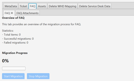

    • FAQ
      • FAQ - Migrates all FAQ data from Web Help Desk to Service Desk.
      • FAQ Attachments - Migrates all FAQ Attachments data from Web Help Desk to Service Desk.

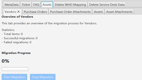

    • Assets
      • Vendors - Migrates all Vendors data from Web Help Desk to Service Desk.
      • Purchase Order - Migrates all Purchase Order data from Web Help Desk to Service Desk.
      • Purchase Order Attachments - Migrates all Purchase Order Attachments from Web Help Desk to Service Desk.
      • Assets – Migrates all Assets data from Web Help Desk to Service Desk.
      • Assets Attachments - Migrates all Assets attachment data from Web Help Desk to Service Desk.

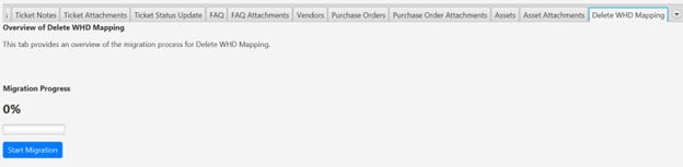

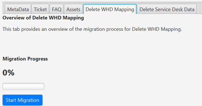

    • Delete WHD Mapping - Deletes all mapping records from Migration utility - Use this option if you have cleared up the Service Desk data and want to perform the migration activity again with the same database.
      The options below are not required for your first data migration.

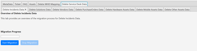

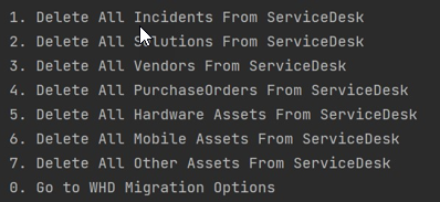

    • Delete Service Desk Data - Deletes all Service Desk data based on your Input. You can pick and choose what specific data to delete.

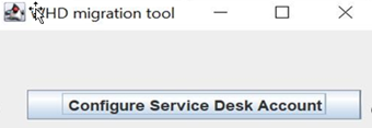

The Migration tool can be executed from different machines for Linux server users or any machine. It is the same as embedded tools with these exceptions:
  1. Database Configuration: Copy the .whd.properties file from the <webhelpdesk>/conf directory and paste it into the <migration utility home directory>/conf folder.
    • For Windows: Go to the migration directory and execute the create shortcut to run migration for window file. This creates shortcut file with name start_migration_tool_in_window to execute the migration utility for Windows OS.
      Execute start_migration_tool_in_window file to start migration utility.
    • For Mac: Open Terminal and locate the migration utility folder, then execute the command below
      sudo sh ./bin/mac_migration.sh
  2. Migrate Approval due_date: If you are using Web Help Desk - 12.8.3 or later, enable this flag.

    asset.categoryFlag=false
  3. If the AssetName flag is set to false, the utility will add Asset: as a prefix to the asset name, resulting in the asset name Asset: +AssetNumber. If the AssetName flag is set to true, the asset name will be only AssetNumber.
    #Default: false
    asset.assetname=false

Migration Step 4: Configure your Service Desk account
Instructions for Windows and Mac OS
  1. When the utility starts, the popup below displays.
  2. Click Configure Service Desk Account.
  3. In Service Desk, navigate to Setup > Account >Account Summary. You need the Account URL from that page.
  4. In the utility tool, add your account URL with https:// before the URL.
  5. When you see the message that the URL is reachable, click OK.
  6. In Service Desk, navigate to Setup > Users & Groups > Users.
    1. In the Name column, select the user account (with Administrator role) you used to set up your Service Desk account.
    2. Click Actions, and from dropdown select Generate JSON Web Token.
    3. Click Copy.
    4. In the utility tool, paste the Web Token.
    5. When the successful connection message displays, click OK.
      The Command Prompt window will display.
  7. Familiarize yourself with the data migration options.
    Option descriptions
    1. Metadata * Migrates all metadata (Locations/Sites, Departments, Categories, Custom Fields, Tech, Clients and User Groups) from Web Help Desk to Service Desk.
    2. Parent Ticket/Incidents Migrates all parent incidents data from Web Help Desk to Service Desk.
    3. Child Ticket/Incidents Migrates all child incidents data from Web Help Desk to Service Desk.
    4. Client/Tech Notes Migrates all client/tech notes data from Web Help Desk to Service Desk.
    5. Attachments Migrates all Ticket and Notes attachments data from Web Help Desk to Service Desk.
    6. Ticket/Incident Status Update Updates all migrated Ticket status from Web Help Desk to Service Desk.
    7. FAQ Migrates all FAQ data from Web Help Desk to Service Desk.
    8. FAQ Attachment Migrates all FAQ attachments data from Web Help Desk to Service Desk.
    9. Vendors Migrates all Vendors data from Web Help Desk to Service Desk.
    10. Purchase Order Migrates all Purchase Order data from Web Help Desk to Service Desk.
    11. Purchase Order Attachment Migrates all Purchase Order attachment data from Web Help Desk to Service Desk.
    12. Assets Migrates all Assets data from Web Help Desk to Service Desk.
    13. Assets Attachment Migrates all Assets attachment data from Web Help Desk to Service Desk.
    14. Delete Mapping Records
    Deletes all mapping records from Web Help Desk database newly created tables.
    Use this option if you have cleared the Service Desk data and want to perform the migration activity again with the same database.
    15. Delete Service Desk Data
    0. Exit Stops the migration utility.
  8. Migrate data using the steps in a-d below.
    As you migrate data, monitor progress on Console.
    1. Use Option 1. Metadata * to start the metadata migration process.
      All metadata is migrated from Web Help Desk to Service Desk. Imported metadata will include location, departments, categories, custom fields, users (tech and client), and User Groups.
      1. Check the progress of the metadata migration on console and see if you see any exceptional failure.
        If you receive an "Operation Complete" message, you can ignore the progress percentage in the console, even if it shows less than 100%.
      2. If you see any failed site/department/category/user/custom field, create it manually in Service Desk and be sure to use the same name when you create it.
      3. Reconcile all the migrated metadata between Web Help Desk and Service Desk.
      4. If all looks good, move on to migrating Web Help Desk tickets.
    2. Use Options 2-6 to start the ticket migration process.
      This step lifts and shifts the ticket, comments, and attachments
    3. Use Options 7-8 to start the FAQ migration process.
      This step lifts and shifts the FAQ and FAQ attachment.
    4. Use Options 9-13 to start the Assets migration process
      This step lifts and shifts the Vendors, Purchase Orders, Assets, and Assets Attachments.

If you observe the "Too Many Requests" error in the logs and the migration is failing or not importing all of the data:
  1. Reduce the thread count in the application.properties file located in the migration utility folder.
    servicedesk.customfields.threadcount=4
    servicedesk.location.threadcount=4
    servicedesk.department.threadcount=4
    servicedesk.categories.threadcount=4
    servicedesk.user.threadcount=5
    servicedesk.usergroup.threadcount=4
    servicedesk.ticket.threadcount=10
    servicedesk.comment.threadcount=8
    servicedesk.ticketstatus.threadcount=4
    servicedesk.faq.threadcount=5
    servicedesk.vendor.threadcount=4
    servicedesk.purchaseorder.threadcount=5
    servicedesk.asset.threadcount=7
    servicedesk.wipe.threadcount=5
  2. After lowering the ticket status thread count to one, if the "Too Many Requests" issue persists, update the below flag to true.
    #Default: false
    servicedesk.ticketstatus.disablethreads=true
