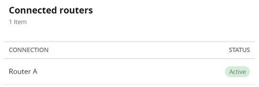

See a connected router from a subnet details page
From the All Connections index page, you can click the link to any subnet details page.
  • If a router is connected, it displays under the heading Connected routers.
    The status of each router displays to the right. Statuses are Active or Inactive.
  • If none are connected, No Router Connected displays.
