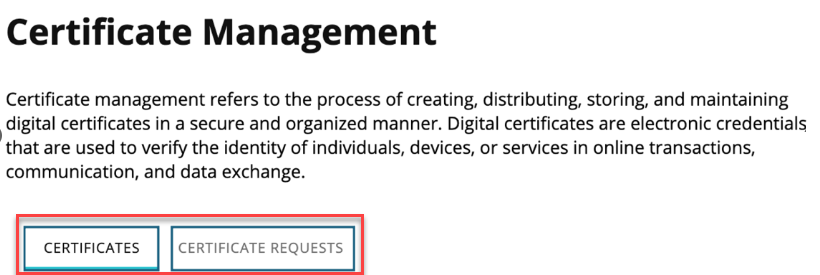

The Certificates management page provides two types of information. Select the appropriate tab to switch between them.
The Certificates tab
The Certificates tab provides a list of all your certificates. This includes those currently in use on your production environment and those you have uploaded as candidates for publishing and deleting.

The Certificate Requests tab
The Certificate Requests tab is where you generate a certificate signing requests (CSR). Alternatively, you can use any tool you want and then upload your certificate through the Certificates tab.

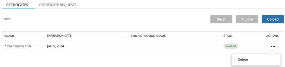

  1. From the Certificates management index page, select the Certificates tab.
  2. Review the list of certificates and notice those with a pending state. See Certificate states.
    If you have renewed a certificate, be aware that you cannot have multiple published certificates with the same CNAME.
    You also need follow the instructions below to set the old one to Pending Delete, and then upload the new one and publish it.

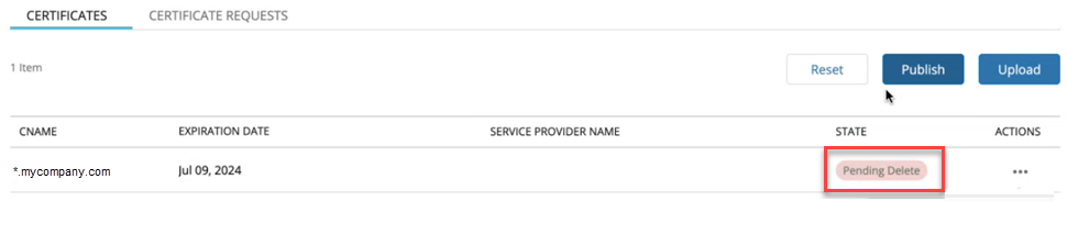

    To set a certificate to Pending Delete, in the Actions column, click the ellipsis to the right of the selected certificate and select Delete.
    Non-ESM customers do not see the column named Service Provider Name.
    The state changes to Pending Delete.
  3. Click Publish.
    When you click Publish, Service Desk performs all actions identified as pending on the Certificates tab. For example, after your expired certificate shows as Pending Delete and your renewed certificate shows as Pending Upload, when you click Publish the expired certificate is removed from the firewall and the renewed certificate is published.
