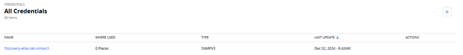

All Credentials index page
The All Credentials index page contains these columns:
  • Name (click to open credential details and edit): The name assigned to the credential
  • Where used: The number of connections or integrations using the credential
  • Type: The credential type; for example, SNMP, SSH, OAuth2, or another type
  • Last update: The most recent date and time the credential was updated
The table below explains the columns on the All Credentials index page.
Column
Description
NAME
It is important to select a meaningful name that assists you in defining your environment.
Click on the name to modify and add a description. You can also update the credentials here. The required details are dependent on the Credential Type.
  • SNMPv3 requires a Username, Authentication Protocol, Authentication Key, Privacy Protocol, and Privacy Key
  • SSH Password only requires a Username and Password.
WHERE USED
Describes the number of subnets and the number of network devices associated to each subnet. For process integrations, it specifies the number of integrations associated with the credential.
TYPE
The selected type of the created credential.
LAST UPDATE
Provides the date and time of the last change.
ACTIONS
When hovering over the row, a trash bin displays. You may delete the credential as long as it is not currently in use.
You can customize the All Credentials index page to a view that best meets your needs. See List view for more information.

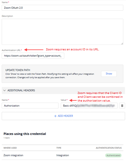

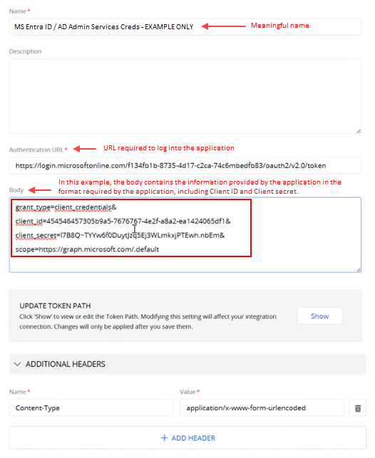

    Examples for authentication method/type OAuth 2.0
    For more information on OAuth 2.0, see OAuth 2.0 prerequisites and additional information.
    Example 1: Service Desk credentials for Zoom
    A use case guide is available providing instructions on how to Obtain Zoom meeting details via bi-directional process integration with OAuth 2.0 credentials.
    Example 2: Service Desk credentials for Microsoft Entra ID
    Changes to the token path or headers may affect existing integrations. Always test changes in a non-production environment first.
