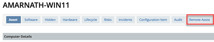

Provide support via an unattended remote session
  1. Navigate to an asset details page. You can do this via an incident or by selecting the specific asset from the Assets index page, for example, Assets > Computers.
  2. With the details page open, click Remote Assist.
If both the public and private API keys have not been provided, unattended support is not available. See Step 1 of Activate Dameware Remote Everywhere Integration.
