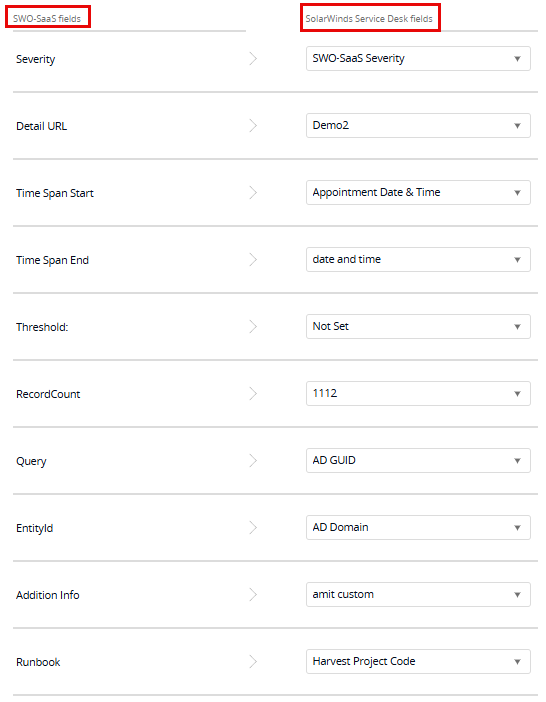

Set up field mapping for SolarWinds Observability SaaS alerts
After setting up your integration between Observability SaaS and Service Desk, you can map fields between the two applications to streamline your integration.
  1. In Service Desk, navigate to Setup > Integrations > Observability SaaS.
  2. When your integration is properly set up and your token is validated, you can select a connector from the Connectors list, and then select the Field Mapping tab to map your fields from Observability SaaS to Service Desk.
