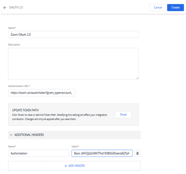

                                    Establish new credentials with the OAuth 2.0 authentication method. (See Credentials.) -
                                            Navigate to Setup > Account > Credentials.
                                            From the All Credentials index, click the Add  icon, and select the OAuth 2.0 credential from the dropdown list. icon, and select the OAuth 2.0 credential from the dropdown list.
                                    In the new credentials dialog: -
                                            Fill in the required information: -
                                                    Name: Zoom OAuth 2.0
                                                    Authentication URL: The authentication URL provided in the Zoom API documentation
                                            Add a new Header for the basic authorization token, obtained from the Zoom API documentation.
                                            Click Create in the upper right to create the credentials.

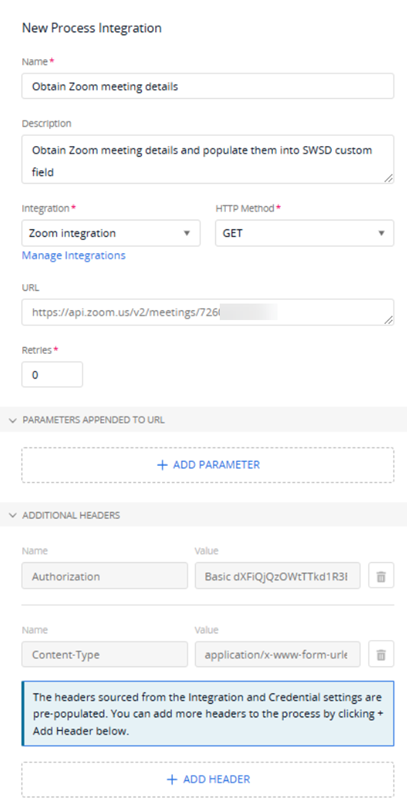

                                            From the Service Catalog item, scroll down to the Process section, and open the process integration configuration.
                                            In the New Process Integration dialog, fill in the required information: -
                                                    Name: Obtain Zoom meeting details
                                                    Description (optional): Obtain Zoom meeting details and populate them into SWSD custom field
                                                    Integration: From the dropdown, select Zoom Integration, which you created in Step 3. When you select the integration, Service Desk prepopulates the HTTP Method, URL, Retries, and Additional Headers including Authorization and Content-Type, as configured in Steps 2 and 3.

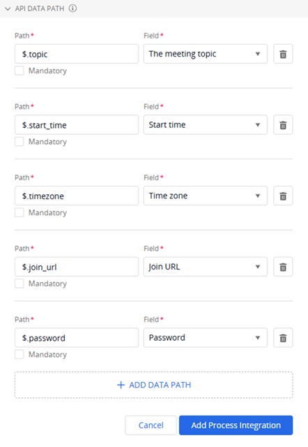

                                            To specify the data you want to extract from the Zoom meeting, define the data elements to parse from the HTTP response in JSON format in the next step of the process integration settings, and map these elements to the Service Desk custom fields where you want the data to be populated: -
                                                    Scroll down to the API Data Path section and click + Add Data Path.
                                                    Fill in the Path and Field for each data element you want to extract from the HTTP response. -
                                                            Path: Use a valid JSON format to specify a data element.
                                                            Field: Select the Service Desk field where you want the data to be populated.
                                                    Click Add Process Integration.
