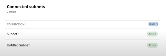

See connected subnets from a router details page
From the All Connections index page, you can click the link to any router details page.
  • If the router has detected any subnets, they display under the heading Connected subnets.
    A subnet identified through a scan by default displays as Untitled Subnet. You can click the link to rename the subnet.
    The status of each subnet displays to the right. Statuses are Active or Inactive.
  • If no connected subnets are detected, No Subnet Connected displays.
