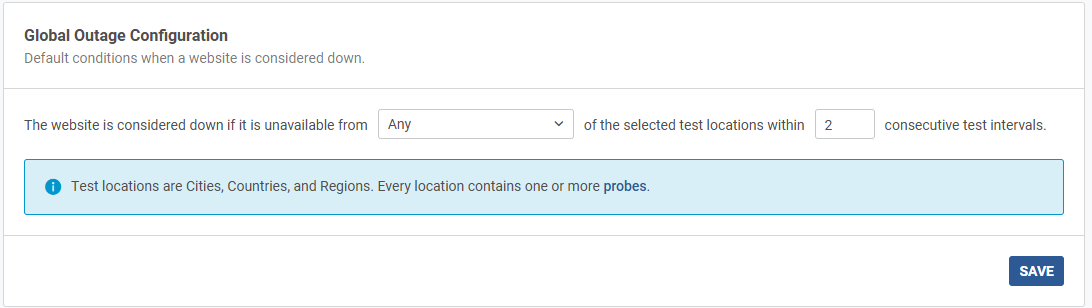

Can I change the outage defaults?
Yes, you can update outage settings by going to Settings > Feature Settings > Digital Experience. Currently, the defaults for an outage are two consecutive test failures in any region for website and URI entities; or one consecutive test failure in any region for Synthetic transactions.
