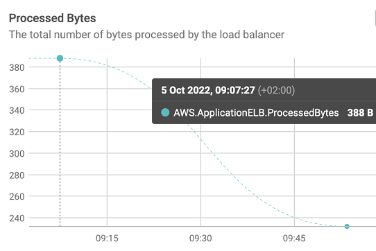

Add Time Series widgets
Time Series widgets display values collected for a selected metric in time on a chart.

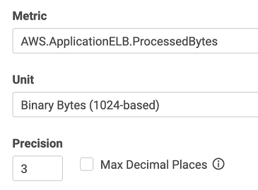

    4. If appropriate, specify the unit.
    5. To set decimal places, select the box, and type the number of places into the Precision box.
      The number in the box sets how many figures will be displayed in the tooltip, both before and after the decimal point. To only display the integer, select the Max Decimal Places box. Numbers larger than the setting in the box are displayed as integers. For example, if the box says 2, numbers like 100,000 will be displayed as 100.

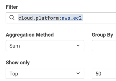

    6. To limit displayed data, select a tag or type a string into the Filter box. Only data corresponding to the selected data will be shown.
    7. Select the Aggregation Method and Group By options in the drop-down menus.

    9. Specify whether you want to show data from the top or from the bottom and refine the number of items to be shown.

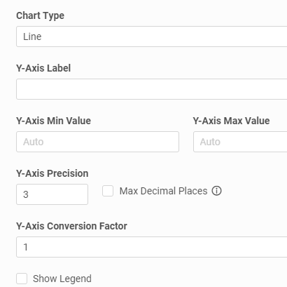

  4. Define the look of the widget.
    1. Expand Visualization.
    2. Select a Chart Type.
    3. Specify the label, minimum value, maximum value, and decimal places for the Y axis.
    4. Specify the minimum and maximum values for Y-Axis values, or select the Auto checkbox.
      • To use values specified by the widget, select Auto. The field will be grayed out.
      • To specify the Min or Max value, clear the Auto checkbox, and specify the value.
    5. Review the decimal places for the Y axis and adjust if necessary.
    6. Specify the conversion factor.
    7. Select Show Legend to display an automatically generated legend.

The widget is added on the dashboard. When there is data for the time interval, the widget starts displaying the information.

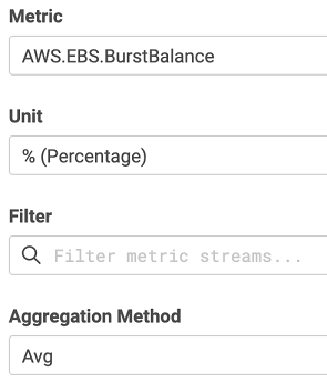

    1. Expand Data and select a Metric.
      To view descriptions of the key metrics for each entity in SolarWinds Observability SaaS, see Metrics for SolarWinds Observability SaaS entities.
    2. If appropriate, specify the unit.
    3. To limit displayed data, select a tag or type a string into the Filter box. Only data corresponding to the selected data will be shown.
    4. Select the Aggregation Method.

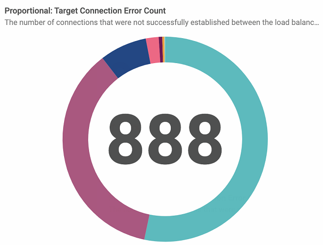

Add Proportional widgets
Proportional widgets display your data as pie charts, donut charts, or stacked bars.
  1. Click Add Widget.
  2. From the drop-down menu in the upper-right corner, select Proportional.

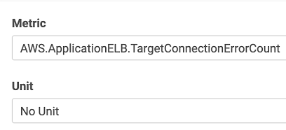

  3. Define data for the widget.
    1. Expand Data and click Add Series.
    2. Select a Metric.
    3. If appropriate, specify the unit.

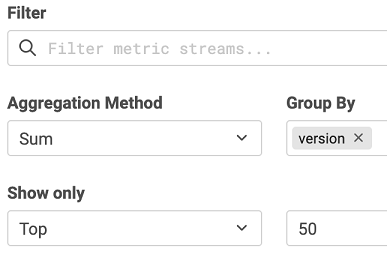

    4. To limit displayed data, select a tag or type a string into the Filter box. Only data corresponding to the selected data will be shown.
    5. Select the Aggregation Method and Group By options in the drop-down menus.
    6. Specify whether you want to show data from the top or from the bottom and refine the number of items to be shown.
    1. Click Visualization.
    2. Select a Chart Type, such as donut, pie, horizontal bar, or vertical bar.
    3. Select Show Legend to display an automatically generated legend.
  5. Define the title and subtitle.
    1. Click Options and type a title for the widget.
    2. If appropriate, provide a subtitle.
    3. To add a link to the widget, select Add Link, and provide a label and link URL. The link is displayed as a button on the widget.
  6. Click Create.
