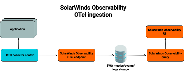

OTel direct ingestion
You can configure any OTel receiver to send telemetry data directly to SolarWinds Observability SaaS. When OpenTelemetry data is ingested directly from the receiver, entities are not created in SolarWinds Observability SaaS. The ingested data is available in the Metrics Explorer and Logs Explorer, and can be added to custom dashboards. Alerts can also be created based on the telemetry data that is received.
Some OTel frameworks are available for a full integration with SolarWinds Observability SaaS, which creates an entity for full observability of your platform or service. See Monitor with OTel for a summary of all OTel options.
