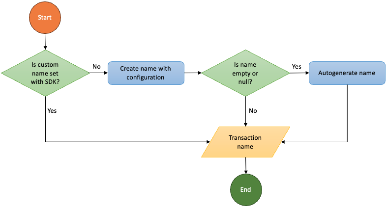

The transaction naming precedence in descending order is:
  1. Custom name set with the SDK
  2. Configured name
  3. Automatic naming
The following flowchart illustrates the process.
