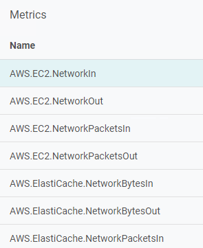

Locate a metric
Use the Search box to search for a specific metric or to filter the list of metrics. When you enter a string in the Search box, the Metrics Explorer displays only the metrics whose name includes that string.

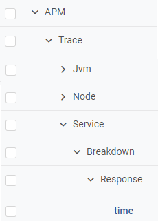

Display metrics as a hierarchy
By default, metrics are displayed as a list alphabetized by the metric name. If you change to hierarchy view, the metrics are organized based on what SolarWinds Observability SaaS module collects each metric. To display metrics as a hierarchy, click the Hierarchy View button .
The first level of the hierarchy represents the SolarWinds Observability SaaS modules and Other. Custom metrics are under Other unless the first part of the custom metric name is the same as a SolarWinds Observability SaaS module prefix.
The following layers are based on the metric name structure. Dots (.) and underscores (_) in the metric name are used to define the hierarchy levels. For example, the metric trace.service.breakdown.response_time would have the following hierarchy levels:
APM > Trace > Service > Breakdown > Response > time
For most metrics, the first part of the metric name (the second level of the hierarchy) represents the data source. If the first part of the name is Trace, that indicates data that is calculated based on traces.

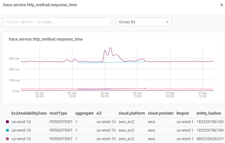

A line chart represents the metric values data collected during the specified time period. To change the time period, click the drop-down menu in the upper-right corner and choose how much historical data to display. You can choose to view all recent data for standard lengths of time, or to view data between two dates.
To show data from a custom time period, choose Custom. In the calendar that appears, click the starting date of your time period and click the ending date. The time period's start and end times default to the current time. To change a start or end time, click the clock next to the time you want to change and click the desired time.
The table below the chart includes a column for each tag associated with the selected metric. Tags provide details about where the metric data came from. For example, a metric that measures the average CPU utilization of a network device might have tags that include the device name, the device type, and the device location. If you are observing devices named Router1 and Router2, then data coming from the first device would be tagged Router1, and data coming from the second device would be tagged Router2.
Most tags are applied automatically, and they are based on defaults during ingestion. For some entities, tags can be customized. For example, when you monitor a service with an APM library, you can define custom tags to be applied to the monitored data.
Each line on the chart and each row in the table represents a measurement stream. A measurement stream is a set of data that came in with the same combination of tag values. For example, a metric has tags indicating the name of a service and the host on which it ran. Data tagged with Service1 and Host1 would be in one measurement stream, while data tagged with Service1 and Host2 would be in a different measurement stream.
View metric values
Position your mouse pointer over the chart to see the metric values for each measurement stream at a specific point in time.

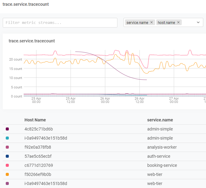

Group measurement streams
To group measurement streams that have the same value for one or more tags, select the tags from the Group By drop-down menu.
When you group measurement streams, each line in the chart represents a set of data with the same values for the selected tags. Values for other tags might be different. The table columns include only the tags used for grouping. In the following example, each line represents data that came from services that have the same name and ran on the same host.
To ungroup measurement streams, click the X in the box that represents each tag name.

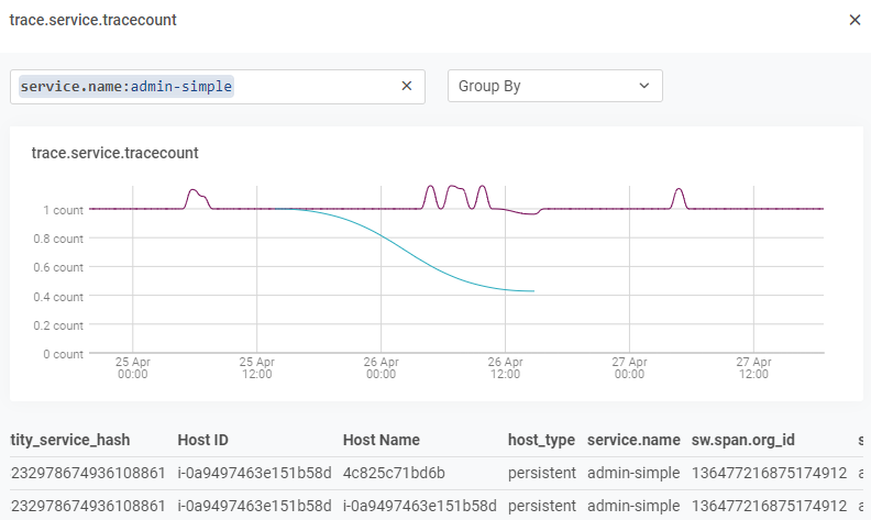

Filter by tag values
Apply filters to see only metric streams with a certain value for one or more tags.
  1. Click inside the Filter By box.
    The Tags drop-down menu displays the tags available for this metric.
  2. Click a tag name.
    The Tag Values drop-down menu displays all values for the selected tag that are assigned to currently displayed metric streams.
  3. Click a value.
  4. Press Enter to apply the filter.
    The chart and table show only measurement steams with the specified value for the selected tag.
    To further refine the list, you can add other tags. If you include multiple filters, metric streams must match all filters.
