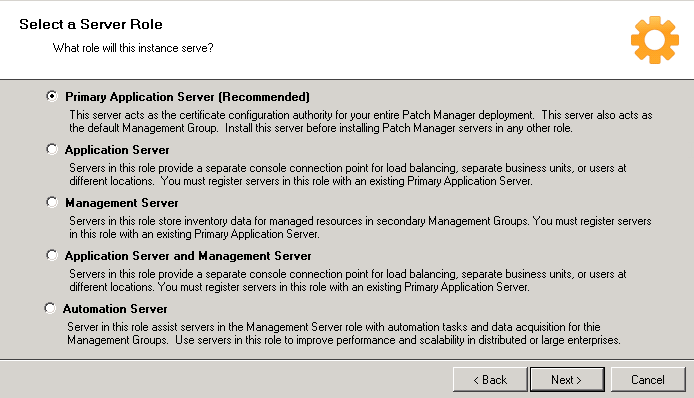

  1. Run the Patch Manager installer on the targeted server.
  2. When prompted, select the targeted server role and click Next.
  3. Complete the steps in the installer.
