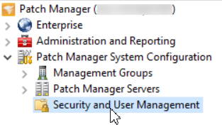

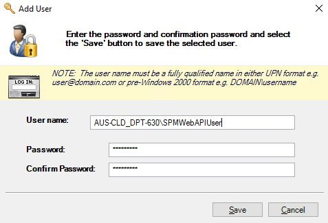

  3. Log in to the Patch Manager Console as an administrator.
  4. Add the user account to the EminentWare Users security role.
  5. In the navigation pane, expand Patch Manager System Configuration and select Security and User Management.
  6. Click the Security Roles tab at the top of the page.
  7. Add the administrator account credentials using the DOMAIN\UserName format, and then click Save.

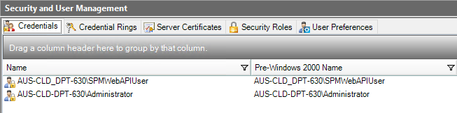

  8. Click the Credentials tab.
  9. Ensure that the new administrator credentials display in the window.
  10. Under name, select EminentWare Users.
  11. Verify that the dedicated local administrator account displays in the bottom center window pane.

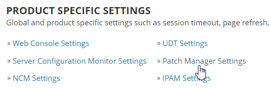

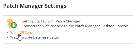

Access the Patch Manager settings in the SolarWinds Platform Web Console

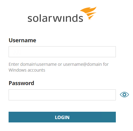

  1. Log in to the SolarWinds Platform Web Console as an administrator.
  2. Click Settings > All Settings.
  3. Locate Product Specific Settings and click Patch Manager Settings.
Set up the Web API
Link the Patch Manager Web Console to the Patch Manager Primary Application Server Web API. This process establishes a communications link between the Patch Manager Web Console installed on the SolarWinds Platform server and the Patch Manager Primary Application Server.

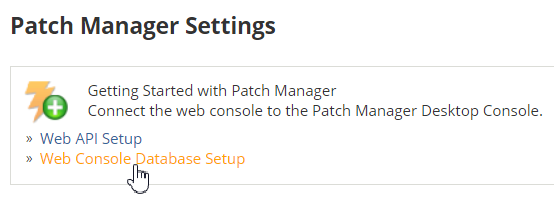

  1. In the Patch Manager Settings window, click Web API Setup.
  2. Enter the server name or IP address of the Patch Manager Primary Application Server.

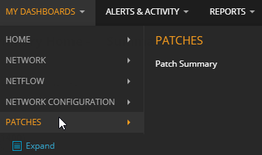

Access the Patch Manager Web Console
After you set up the Web API, you can access the Patch Manager Web Console in the SolarWinds Platform Web Console at My Dashboards > Patches > Patch Summary.
This dashboard view may vary depending on your configuration.

  1. Click Settings > All Settings.
  2. Locate Product Specific Settings and click Patch Manager Settings.
  3. Click Web Console Database Setup.

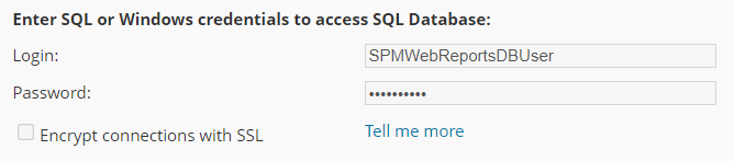

  4. Enter the IP address of your Patch Manager SQL Server database.
  5. Enter the SQL or Windows server login credentials of a user in your organization with administrator access to the Patch Manager database. These credentials will be used to create a read-only user account to query the Patch Manager database and populate the reports.
    For example:
    SPMWebReportsDBUser
    To prevent unauthorized access to your Patch Manager database, avoid using sa or .\Administrator for your login credentials.
  6. (Optional) Select the Encrypt connections with SSL checkbox to encrypt the network traffic between the SolarWinds Platform server and the Patch Manager SQL database server using the SSL certificate on the SQL server.
    This option requires a provisioned SSL certificate on the SQL server. Forcing the SQL server to require encryption is not required.
  7. Click Connect to test the connection.
    If the credentials are valid, the window will display a green Connection succeeded message.

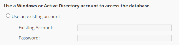

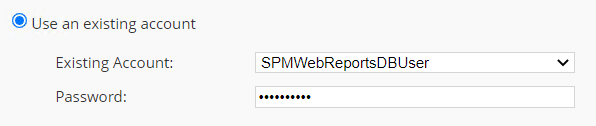

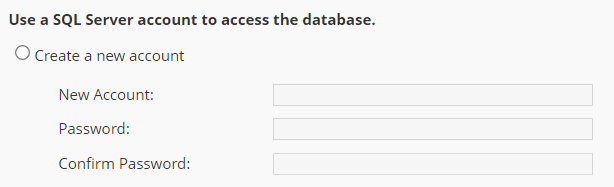

  8. Select the SQL Server account used by the Patch Manager database.
  9. Select or create a user account to access the Patch Manager database and populate the reports. This account will be read-access only.
    To use the existing SQL Server account you entered in step 5, leave the current option selected.
    To use an existing Windows or Active Directory account, select Use an existing account and enter the account name and password. Record and save your account credentials in a safe place.
    To create a new SQL Server account, select Create a new account and enter a new account name and password. Record and save your account credentials in a safe place.
  10. Click Submit.

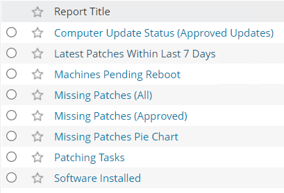

Access the Patch Manager reports
After you configure the database settings, you can access the Patch Manager reports in the SolarWinds Platform Web Console.
  1. In the SolarWinds Platform Web Console toolbar, click Reports > All Reports.
  2. Click the Group By drop-down menu and select Product.
  3. Under Group By, select SPM Reports.
  4. Click a report in the window.
