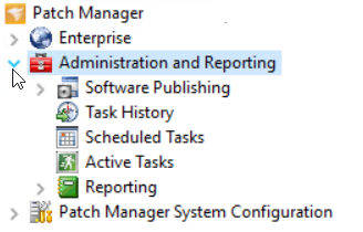

- Log in to the Patch Manager Console.
In the navigation menu, maximize Administration and Reporting.

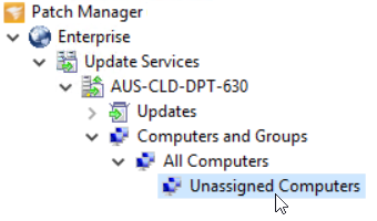

- In the navigation pane, expand Enterprise > Update Services.
Maximize your WSUS server > Computers and Groups > All Computers and select Unassigned Computers.
In the top center panel, locate the targeted computer.
Click Add selected.

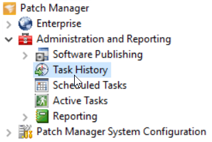

In the navigation pane, expand Administration and Reporting and select Task History.
In the Task History window check the task status in the bottom center panel. If the task was successful, Success displays in the Status column.
