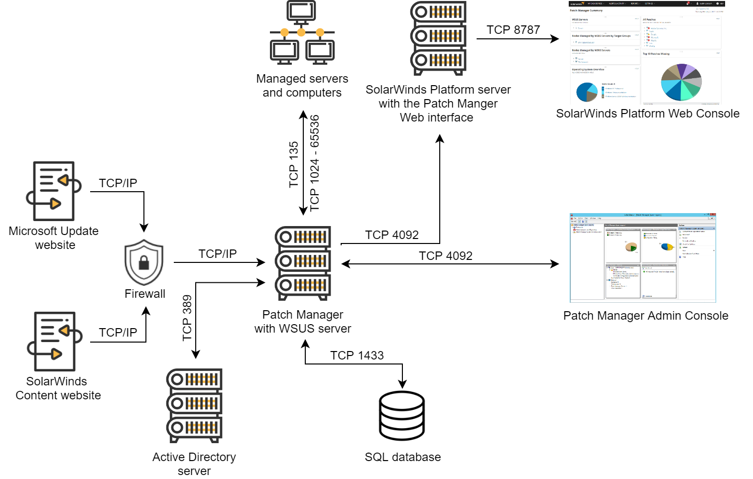

The following illustration shows an integrated installation connected to an external database server running SQL Server.
