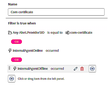

SolarWinds recommends creating a filter to manage the certificate update process. Below is an example of the parameters you can use to create a certificate audit filter and manage the certificate update process.
where Any Alert.ProviderSID is the security identifier (SID) of your targeted alert provider.

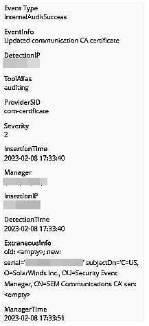

Below is an example of the audit results for a CA certificate update.
