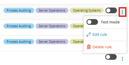

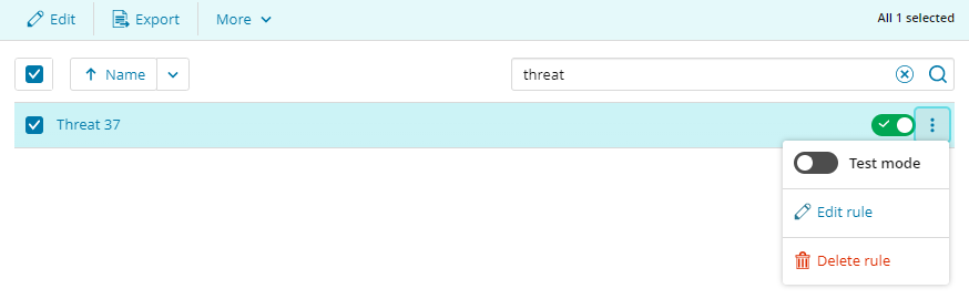

- On the toolbar, click the Rules tab.
- To disable a rule, click the enabled toggle button next to a rule. To edit, delete, and toggle test mode, click the vertical ellipsis next to a rule.

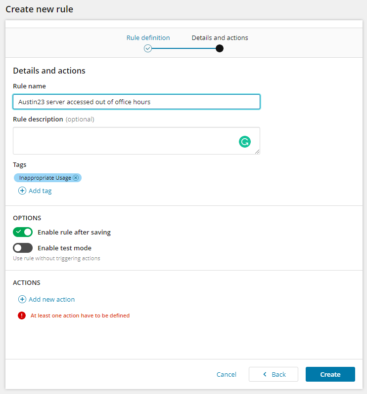

Enable rules from the rules builder
                                    Log in to the SEM Console.
- On the toolbar, click Rules.
- Click the vertical ellipsis next to a rule, and then select Edit rule.
- Click Next.
- Under details and actions, click the toggle button to enable the rule after saving, and then click Save.

Enable or disable test mode in the Rules list
- On the toolbar, select Rules.
                                    To disable a rule, click the enabled toggle button next to a rule. To enable or disable test mode, click the vertical ellipsis next to a rule, and then toggle Test mode.
Enable or disable test mode from the rules builder
- Click Next.
- Under Details and actions, click the toggle switch to enable or disable test mode, and then click Save.

Disable rules from the Rules builder
- On the SEM Console, select Rules.
- Click Next.
- Under details and actions, toggle off the Enable the rule after saving, and then click Save.
