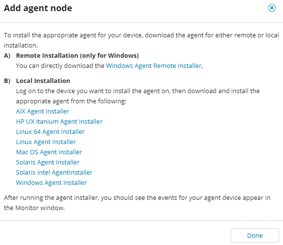

                                    In the toolbar, click Add agent node.
                                    Download the required installer(s).   -
                                            (Remote Windows installation only) Click Windows Remote Agent Installer to download the installer to your system.
                                            Under Local Installation, click the agent installer that matches the operating system running on the targeted device. For example, if your targeted device is running Linux, click Linux Agent Installer.
                                    Click Done.
