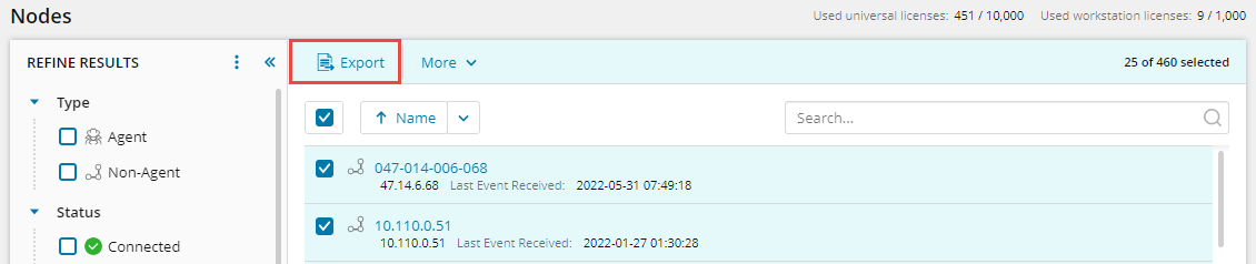

Export the SEM node information
Perform the following steps to export the details of individual or multiple nodes to CSV file.
- Log in to the SEM Console.
- On the toolbar, click Configure > Nodes.
If necessary, use the options in the left column to refine the nodes list.
Select the node or nodes you want to export.
Click Export.
A CSV file containing the details about your selected node(s) is saved to your system.
