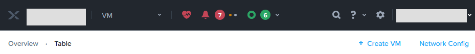

  1. Go to VM > Table and click Create VM.

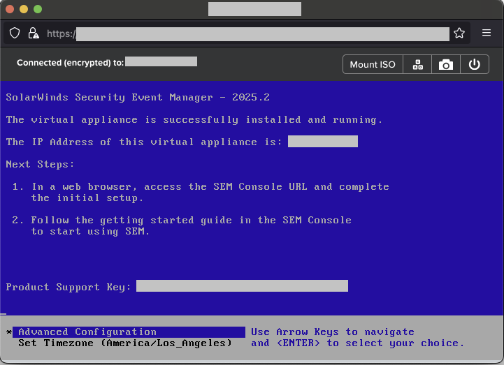

  11. Power on the machine and then launch the console to reach the BSOL.
