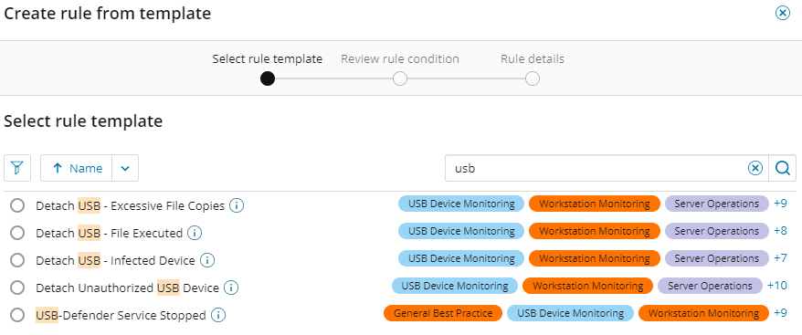

USB devices are not detached by default. You must configure a rule to detach the device. The SEM Console includes several templates you can access and modify, as shown below.
