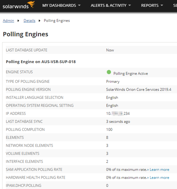

Use the Polling Settings page to customize global polling rates, distribute Orion Platform agents across polling engines, and more. For details, see Optimize polling engines and Manage Orion Platform Polling Engines.
To check the status of multiple polling engines:
- Click Settings > All Settings.
- Scroll to the Details section at the bottom of the page, and then click Polling Settings.
- Review the Polling Engines page to determine the source(s) of your excess polling load.
Note the following details about this page:
- The SAM Application Polling Rate pertains to polling jobs for SAM application monitors (also called "applications") assigned to nodes. To calculate polling for AppInsight applications, SAM uses the actual number of component monitors that are actively polling, as opposed to the flat rate used to calculate license consumption for component-based licensing.
- Many Orion Platform statistics use the term "elements" which typically refers to managed nodes, interfaces, or volumes. For SAM, polling statistics are usually expressed as "components," a reference to component monitors within SAM application monitors that gather specific metrics for applications, processes, and so on. To learn more, see Work with SAM component monitors or watch SolarWinds Lab Bits: Common SAM Template Elements.

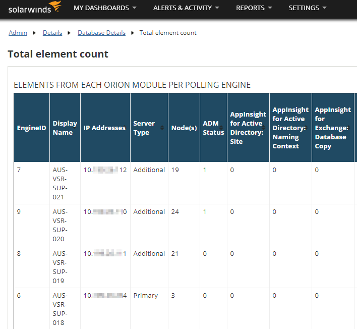

Determine how many SAM component monitors are assigned per polling engine
To check the number of component monitors to each polling engine:
- Scroll down to the Details section, and then click Database Details.
- Scroll to the bottom of the Database Details page, and then click Total elements per poller.
- Review the information provided on the Total element count page.

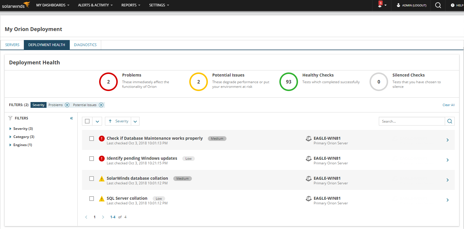

Check deployment health regularly
The Active Diagnostics tool runs daily to detect current or potential issues with the Orion server that often functions as the Main Polling Engine, the database, and any Additional Polling Engines. After analysis, this tool provides summaries with links you can follow to resolve issues.
- Click Settings > My Orion Deployment.
- Click the Deployment Health tab.
- Review details about your environment. Optionally, sort issues by priority.
- To investigate a specific issue, click the arrow at the end of the row. Review details that appear and follow any links provided to resolve the issue.
