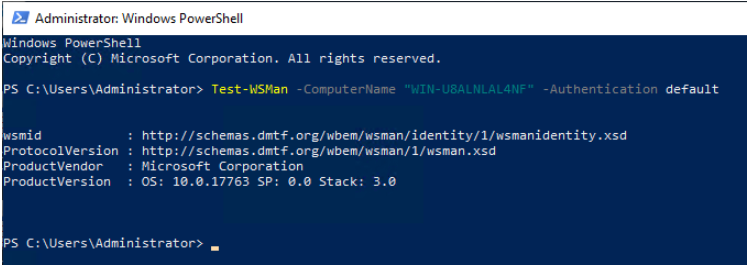

Verify the WinRM connection from the SolarWinds Platform server to each target node by entering:
Test-WSMan -ComputerName $TargetNodeHostName -Authentication defaultIf the SolarWinds Platform server and a target node have the same credentials, results will look similar to this example.

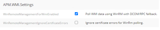

Disable WinRM polling on the SolarWinds Platform server
The WinRM feature is enabled on the SolarWinds Platform server by default. To disable this feature at the global level, adjust APM.WMI.Settings on the Advanced Configuration page.
Log in to the SolarWinds Platform server as an administrator.
Copy the following text:
/Admin/AdvancedConfiguration/Global.aspx -
Paste text into your browser address bar, after
/Orion, as shown here:<your product server>/Orion/Admin/AdvancedConfiguration/Global.aspx -
On the Global tab of the Advanced Configuration page, scroll down to APM.WMI.Settings.
Clear the WinRemoteManagementforWmiEnabled check box, and then scroll down to click Save.
Restart SolarWinds Platform services in the SolarWinds Platform Service Manager, and then wait a few minutes for changes to occur.
Ignore certificate errors during WinRM polling
By default, WinRM flags invalid certificates found during polling, including self-signed certificates over HTTPS. When this occurs, messages similar to the following appear in logs:
Fetching WMI query failed by 'SolarWinds.APM.Probes.Management.WinRM.WinRmConnection'.
You can configure WinRM to ignore invalid certificates by enabling the WinRemoteManagementIgnoreCertificateErrors setting on the Advanced Configuration page.
Neither SolarWinds Platform agents nor SolarWinds Platform Remote Collectors respect centralized settings adjusted on the Advanced Configuration page.
Select the WinRemoteManagementIgnoreCertificateErrors check box, and then scroll down to click Save.
