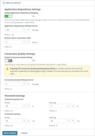

Manage Application Dependency polling
After SAM deploys agents to monitored nodes, Application Dependency polling scans nodes twice in the first ten minutes and then every two hours to:
                                    Detect connections between applications, application processes, and nodes. SAM also detects "from” and "to" nodes that rely on server-initiated communications, known as “passive agents” or “agentless" nodes.
                                    Identify nodes as either targets or clients.
                                    Gather IP address and port data.
                                    Display data in the Application Connections widget on the Node and Application Details views.

- Navigate to the Application Connection Settings page.
- Toggle the "Clear the Application Dependency Mapping" option.
- Click Save changes.

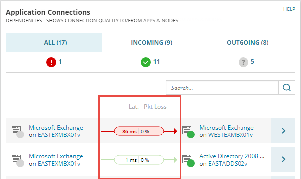

Manage Connection Quality polling
In addition to showing how nodes connect to applications and application processes, the Application Connections widget and Connection Details page can display TCP latency and packet loss metrics if Connection Quality polling is enabled.
To gather TCP data, SAM deploys agent plugins to nodes to track communication traveling from clients that host applications and application processes to target nodes detected by Application Dependency polling.

Enable Connection Quality polling
- Under Connection Quality Settings, toggle the Enable Connection Quality Polling option to On.
Disable Connection Quality polling
If you disable the Connection Quality Settings option on the Application Connection Settings page, SAM stops gathering latency and packet loss metrics but continues to gather application connection data. The status of connection entities appears as Unknown on the Connection Details page.
- Under Connection Quality Settings, toggle the Enable Connection Quality Polling option to Off.
When you disable polling, SAM removes agent plugins that delivered Npcap drivers but does not remove the actual drivers. If remaining drivers present a security concern for your organization, see Remove an Npcap driver after disabling Connection Quality Polling.
